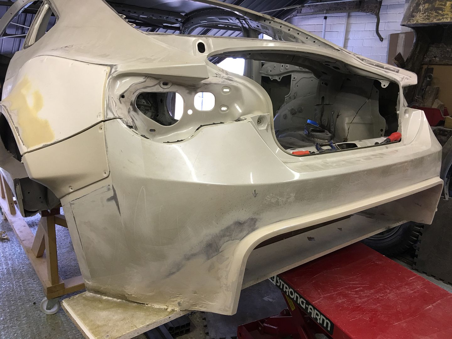

As promised, here's an update with a pretty pic to show you all.
The rear end is all cut away to allow a nice big diffuser to fit under the custom subframe. The arches are boxed in to wrap around the tyres and the insides of the cut out are parallel to the inner tyre wall.
I need help deciding what to do with the bottom edge.
The plank is just a building block.

As for what to do with the bottom edge, have you considered having the diffuser running across the full width of the car? The Speedhunter's Scion FRS that was built for SEMA seems to run a very similar rear end to your 86, and this was all they did:
Thanks for the advice my friend.
The car will run a full width diffuser, but I was asking what people thought I should do with the bottom edge either side of the diffuser cut out. I have now decided it will be squared off and featureless.
Hopefully I will have pics up tomorrow of the finished buck awaiting paint.
