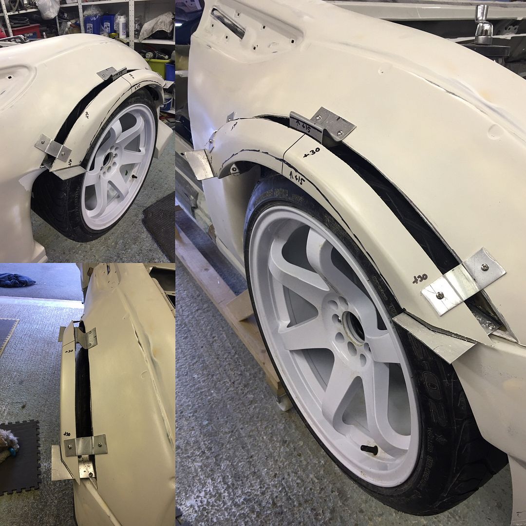

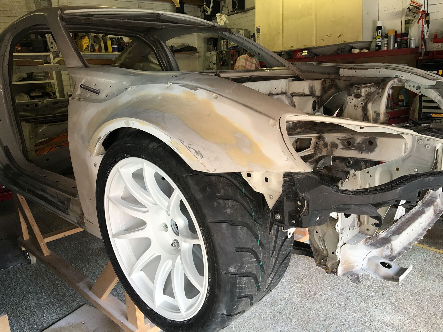

Ok guys, it's been a little while. I have made a mould of the front bumper now and am now concentrating on getting some wheels sorted so I know where I'm going with this. I have decided on 11" wide all round with 315/30 tyres.
Here we can see the chosen wheels. Work of Japan MCO Racing in 11x18 et 18, kindly loaned to me by Driftworks and Rich Starkey.
It's too wide for the stock RB v1 fender, so I've done this.....

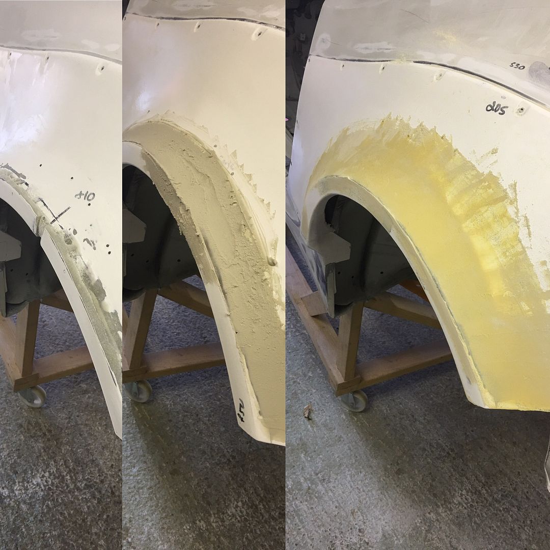

This is the start of a RBv1 fender getting widened by 33mm and raised by 15mm to get those massive tyres in and have the car low!!

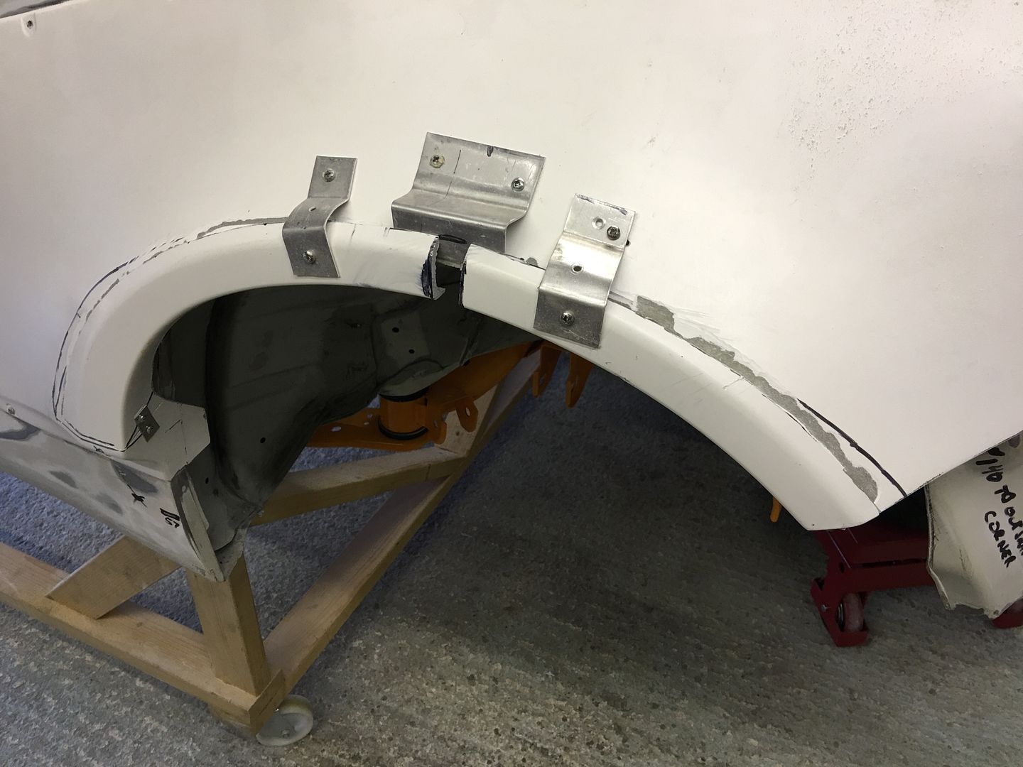

A busy day with saws, fiberglass and filler got me to this stage.
Loads more work required, but we can all see where this is going!!

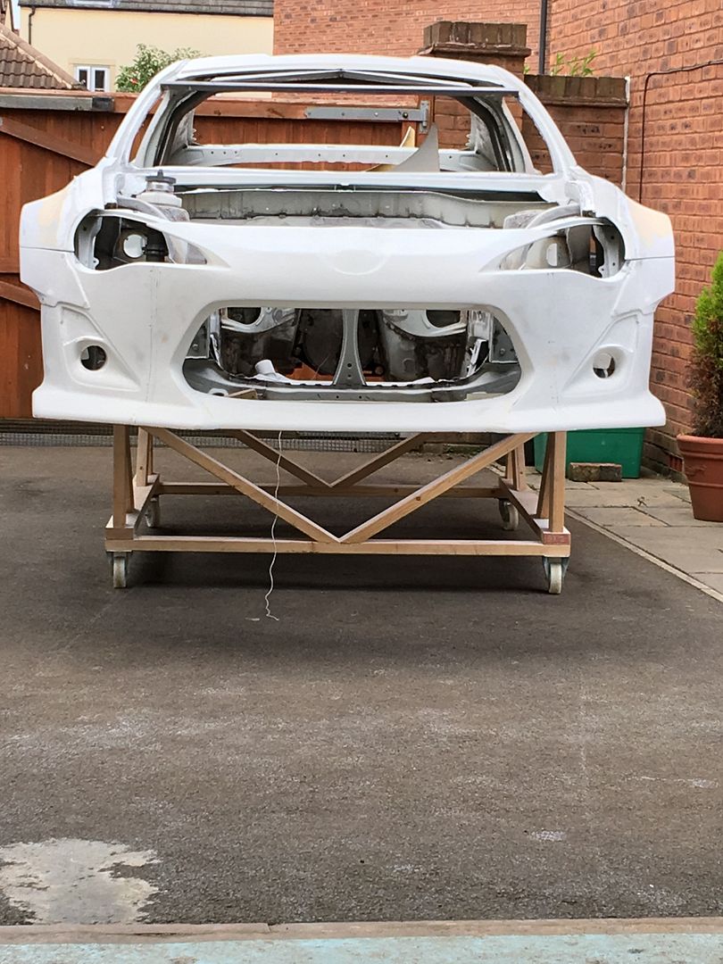

This afternoon was productive!
I like it, what do you think? Time to start making moulds.

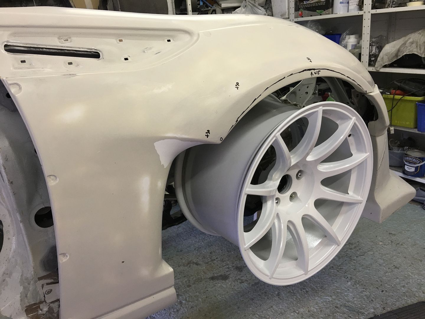

I messed up guys!! I made the first pair of bucks too wide!!
So, I've cut them down by 10mm per side. Old age doesn't come alone guys, I know we all make mistakes, but I am a muppet.

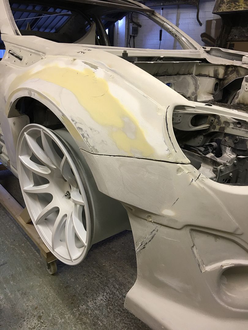

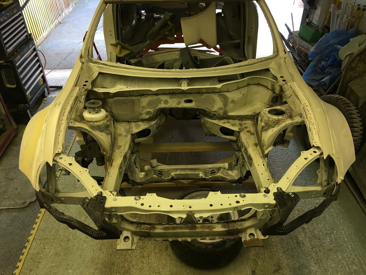

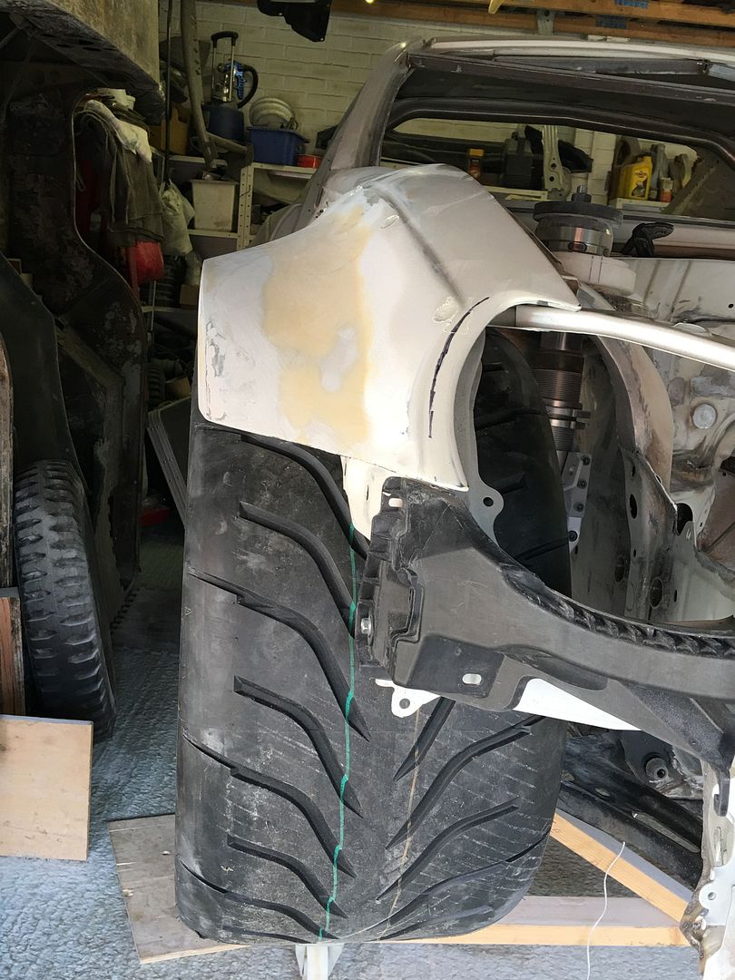

So, I finally got the changes made and now have the front all done ready for final fitting of wheel and tyre and then add al the rads and fillets, primer and make moulds.
Here we can see it's slightly wider, 23mm per side but the biggest difference is the height, allowing bigger tyres/lower ride height.
In this pic you will spot a billion mods if you look carefully..

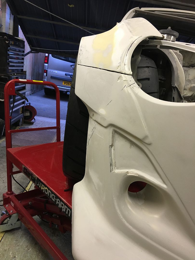

Finally, for anyone asking "Why oh why did he cut all that metal out of the inner fenders"? Here's your answer. look at the tyre inside the arch under the tower.

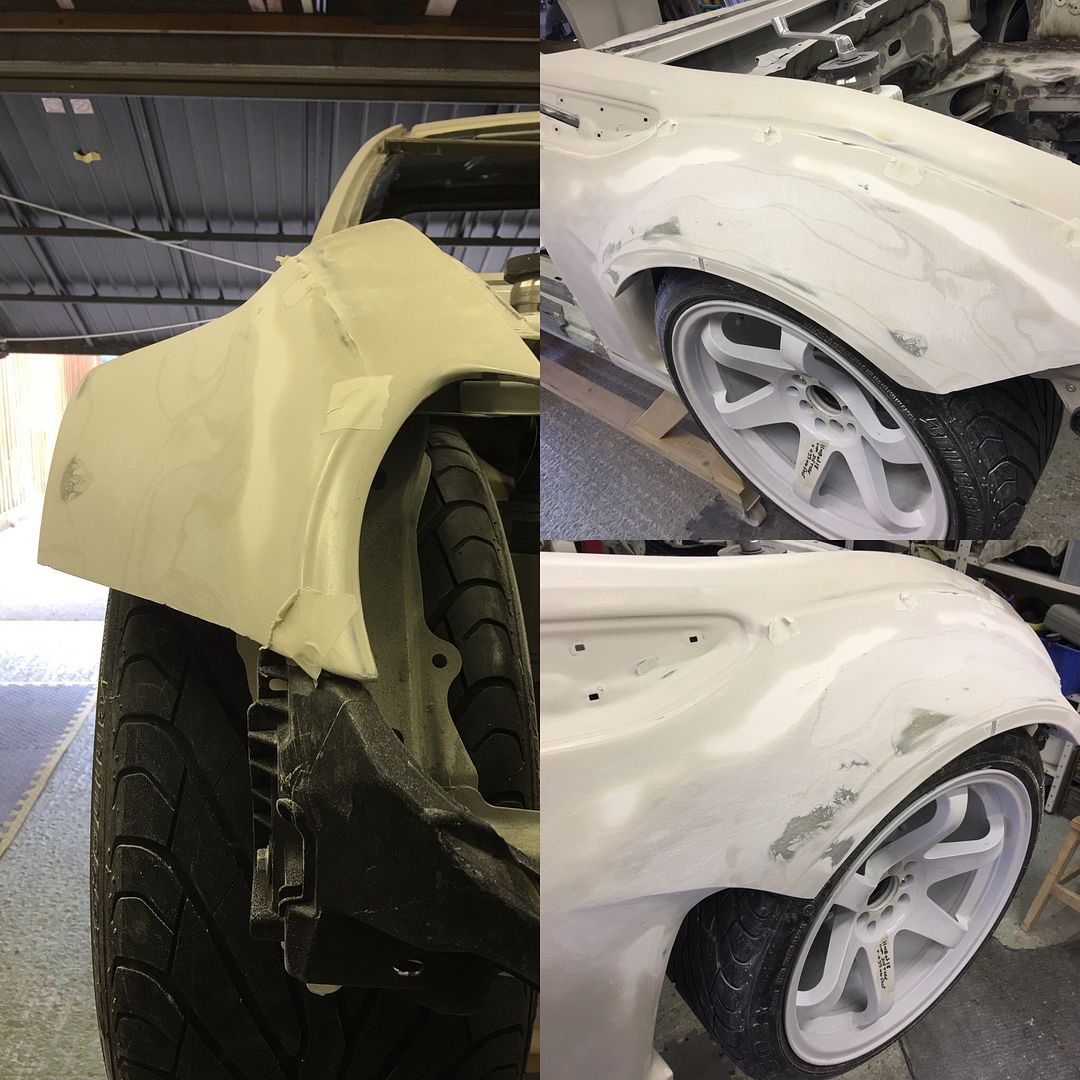

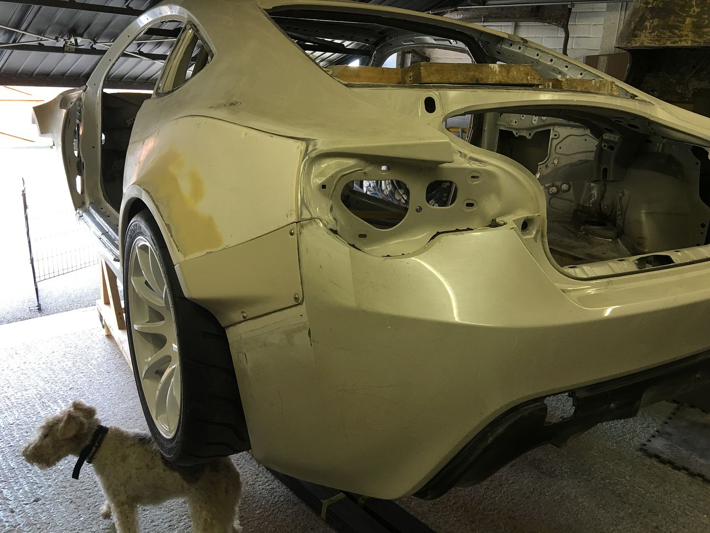

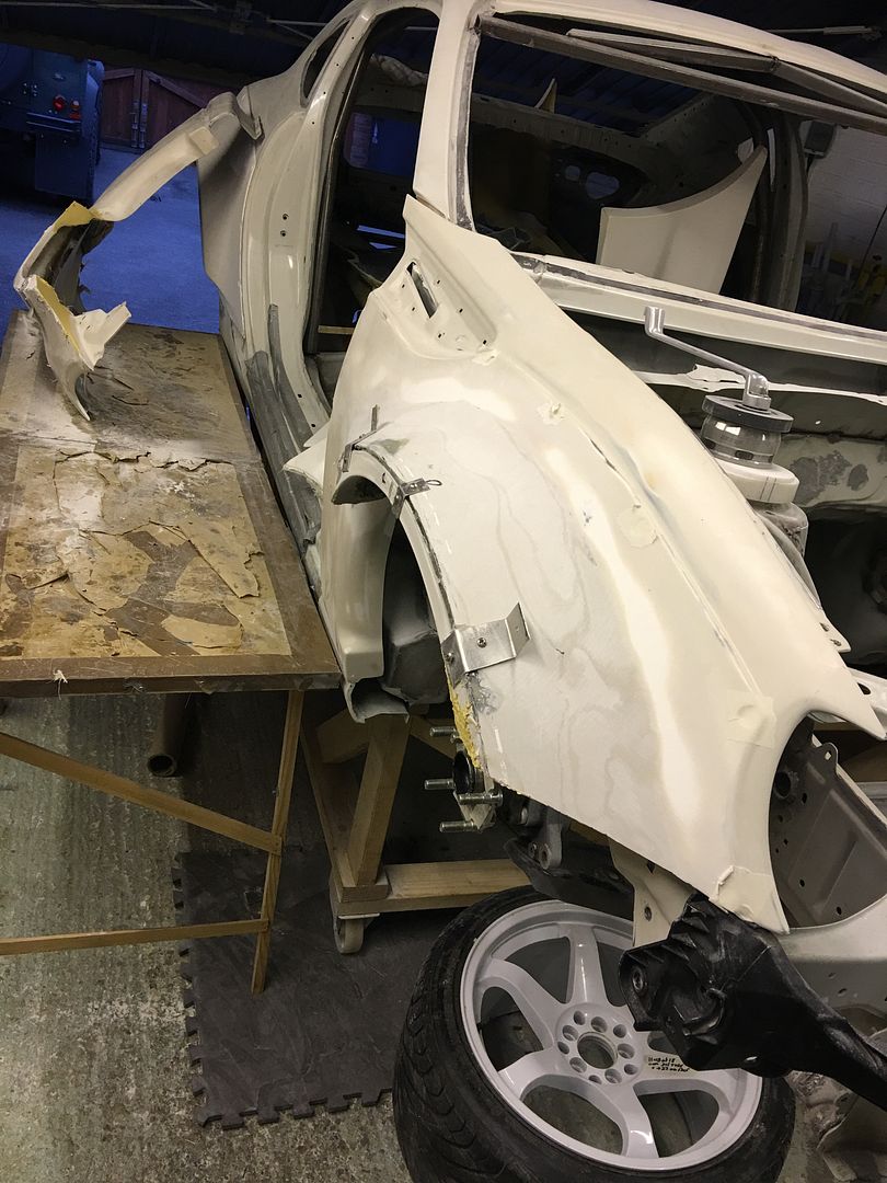

And so, we have the rears being modified.. No wider, just taller.
Thanks for watching..

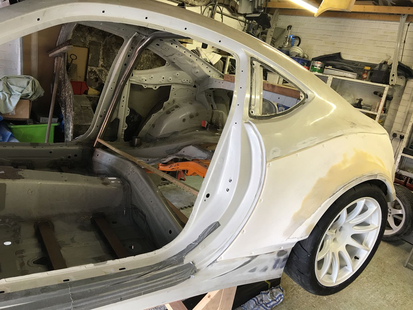

After a long hard slog I finally have the rear arches sorted. I have also had a Toyo 888 fitted to my Work MCO 11x18 et 18. This is where the wheel will sit at about 60mm drop.

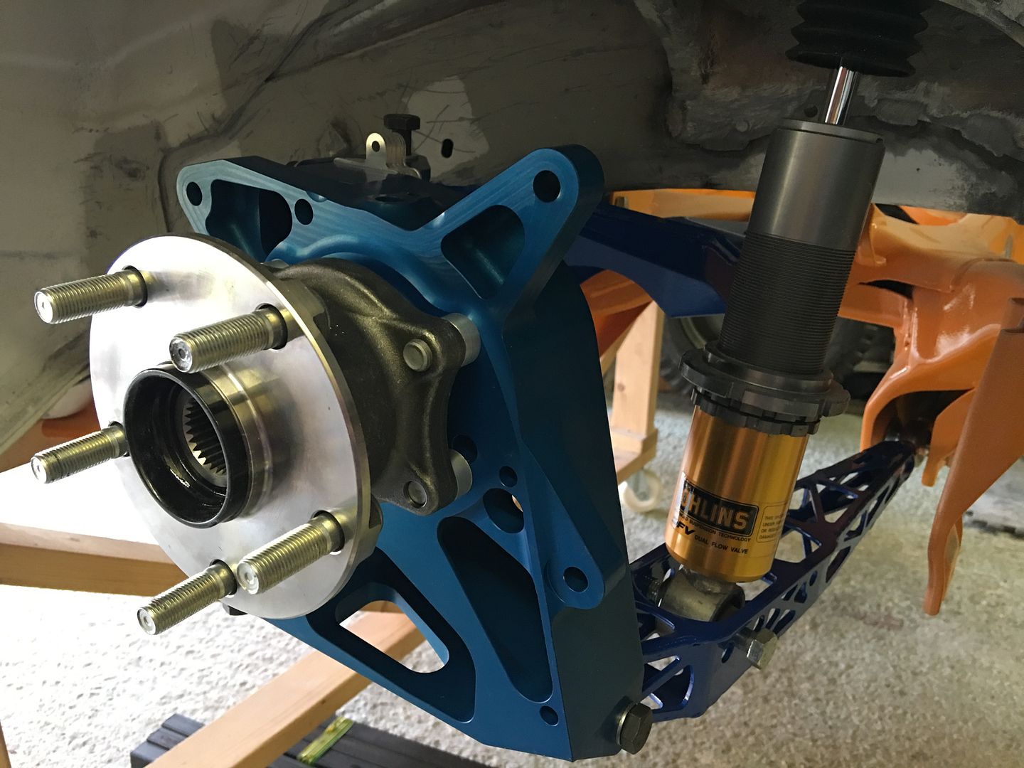

I have also trialled the wheel on my new Wisefab rear end. This kit is simply awesome, with loads of benefits over the stock rear end such as a massive weight saving and roll centre correction, even if youre not lowered, the roll centre on your car could do with raising.
Heres a couple of shots of the front end with the 11 x 18 on and modified arches.
Now you can see why I took out all that metalwork in the inner wheel arch
