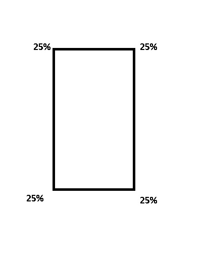

Originally Posted by MarkR171 View Post
Weight balance side to side and back to front.
That's not the goal of corner weighting.
As you've described it you are seeking to do this.
Old 09-19-2016, 10:03 PM   #8
x808drifter
LMGTFY
x808drifter's Avatar
Join Date: Mar 2016
Drives: 13 FRS, 91 Miata
Location: Lava Town, HI
Posts: 2,776
Thanks: 5,561
You want 50-50 cross.
FL-RR, and FR-RL

^ Yes, more detail:
Corner balancing is more like "leveling" a dinner table than "balancing" weight distribution. The weight at each corner of a car, on a level surface, is more of an indicator of the suspension's length/height at each corner than an "end" unto itself.
A car with poor corner balancing is similar to 4-legged dinner table that can rock back and forth when two opposing corners' legs are longer than one or both of the other two. But, whereas a table will rock back and forth over the long-legged axis, and alternately lift the two shorter leggs off the ground, making the issue obvious, the springs on a car will keep all four tires in contact with the ground and mask the issue.
The 4 individual scales, and the resulting weights, show how much force each tire is putting on the ground while at rest.
Less force (weight) on a cross-weight (DF+PR vs PF+DR) means one or both of the "table legs" are too short relative to the heavier cross weight. Or, conversely, the heavier cross-weight has a "leg" or "legs" that are to long.
Twinz is offline   Reply With Quote
Attachment 143264
That's fair, but I meant them as two different things. 50/50 left:right (mainly) and/or 50/50 f:r
That's still not the goal. See @x808drifter's post above.
Static 50% front/rear distribution is a marketing ploy.
