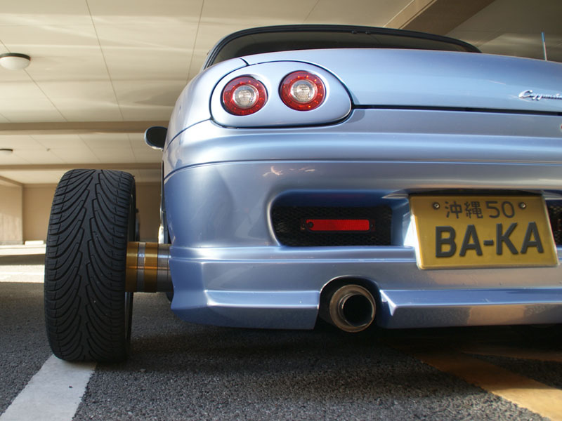

Sure you can

Holly Shit. I'm pretty sure that's unsafe!
