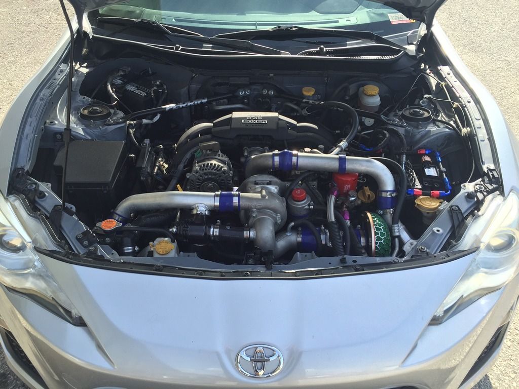

Old 08-03-2016, 10:15 AM   #332
Andew727
Drives: Scion FR-S
Location: Palm Harbor, Florida
Posts: 143
Thanks: 23
Thanked 44 Times in 35 Posts
[IMG][/IMG]
[IMG][/IMG]
Andew727 is offline   Reply With Quote
