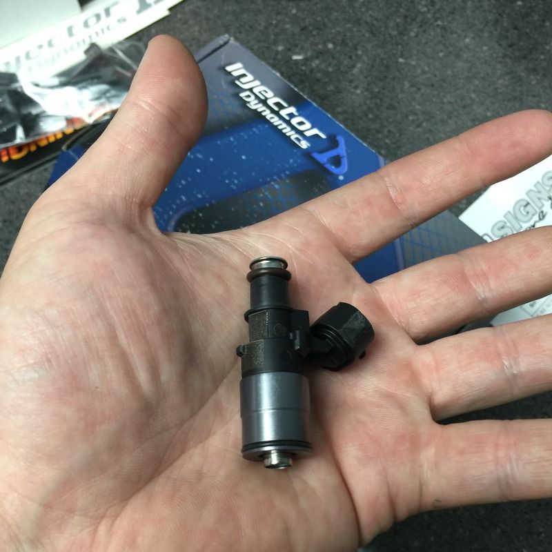

ID2000's were installed saturday, just need to finish up the tune when my guy has time

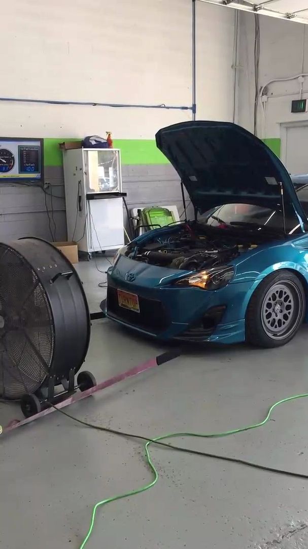

only pull video i took, and it was an early one. we cut around 7k rpm and were only on wastegate spring pressure. around 500ish whp. this was before we started adding in timing as well. around 18 degrees in boost

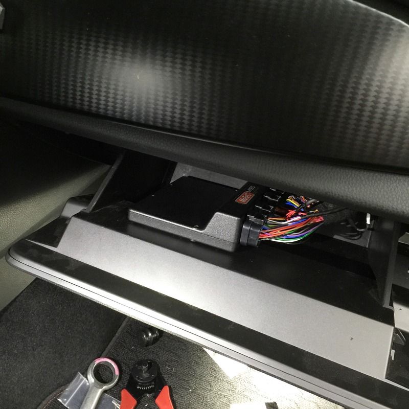

ID2000's are in, continuing tuning on thursday. ecu is mounted in the glove box, and i was playing with the launch limiter a little the other day. already makes a little boost with just the limiter. should do very well with the anti lag timing/fuel settings enabled.

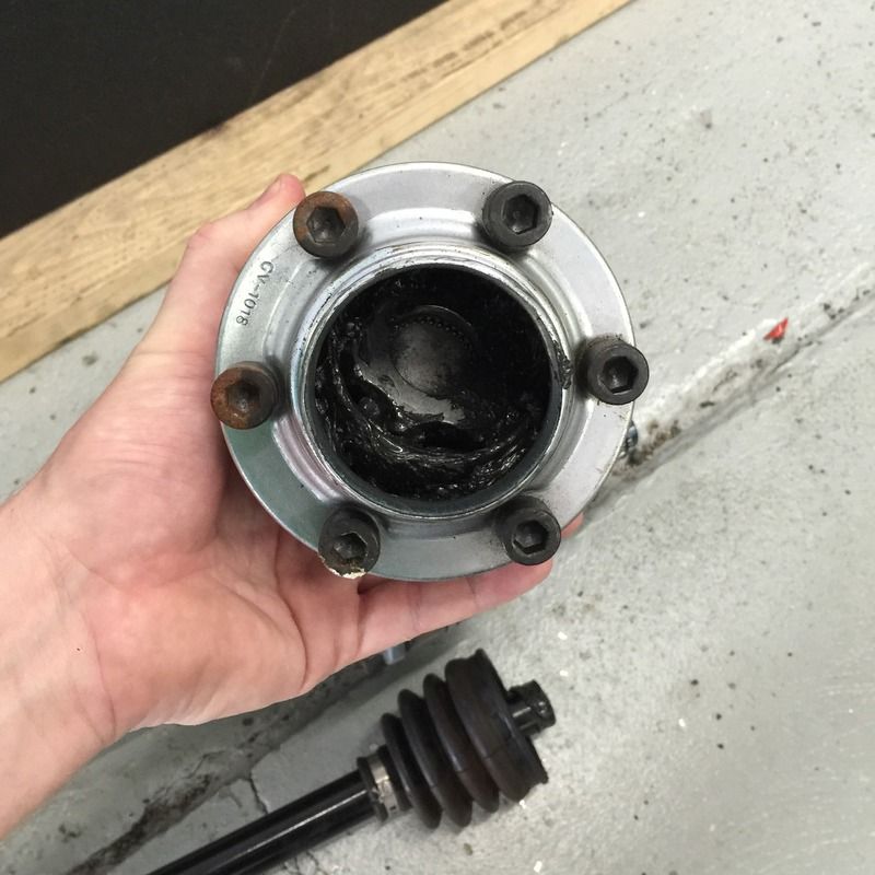

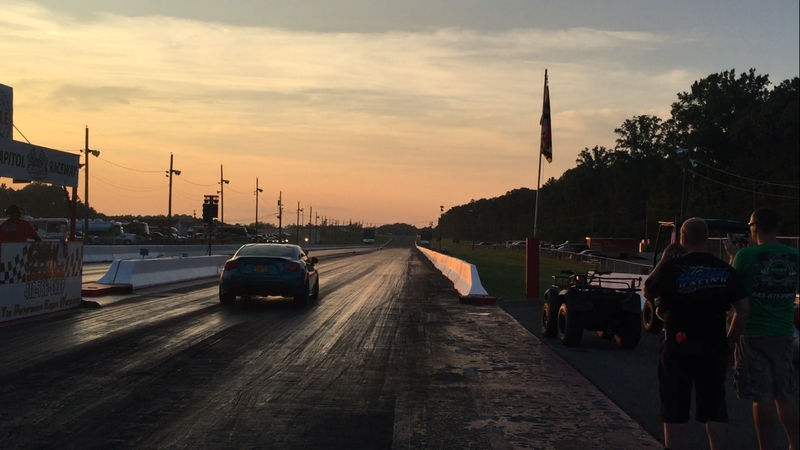

went to the track friday night. snapped the drivers inner shaft, as well as passenger outer joint. these are DSS 600hp axles. moving to the 1000hp setup with the larger hubs and running a 26x10x15 slick at the track to soak up some of the shock in attempt to keep this from happening again.
