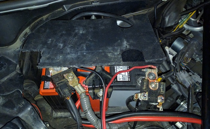

I'm on the PowerSonic batteries still, going to upgrade to three PC680s soon. What all do I need to get in terms of install parts so that I have everything when the batteries arrive? Sounds like I need a longer copper dump connector (can't you just use some heavy gauge wire for that?). Does the old plastic top cover not sufficiently protect the connections on the new batteries?

Not sure what your cables/barriers look like since I started on the ETX16s but here is a pic of mine with the provided barrier sitting ontop. Since I don't have 3x PC680s yet, I couldn't use the barrier as my ETX16 starter battery terminals are facing right which made it not sit with the holder/terminal wood block ontop.
I think with 3x PC680s it would sit fine though.
For connecting the two batteries together I am sure thick gauge wire would be fine if you could secure it. Personally I think using a copper bar would be cleaner and simpler. You can purchase a bar from McMaster-carr with approximate dimensions of 6" long x 0.5" wide x 1/8" thick ($2.45 + ship), cut off the excess length you don't need, and drill two holes for the bolts to go through and you're good to go.
http://www.mcmaster.com/#8964K4

What he said.
