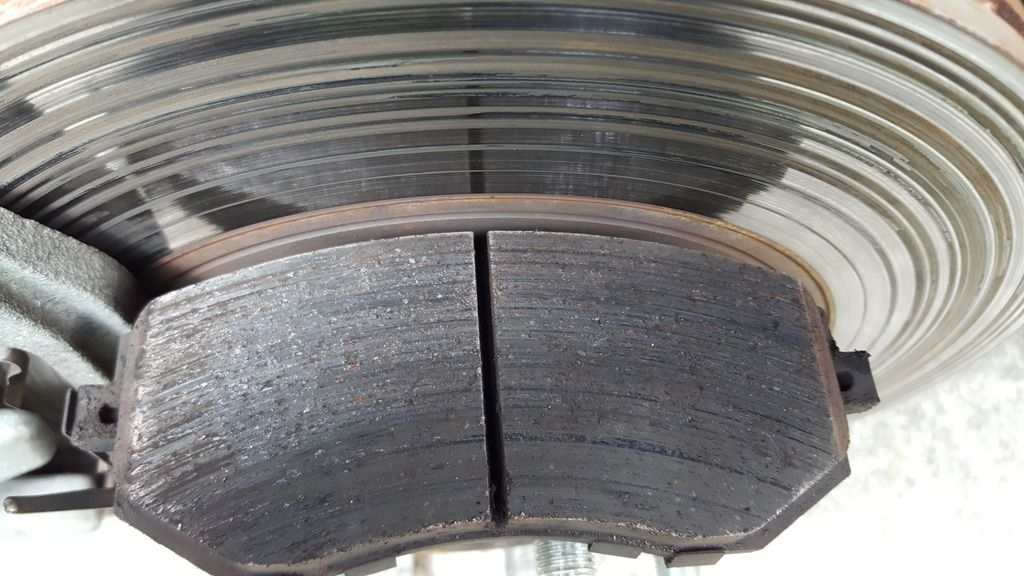

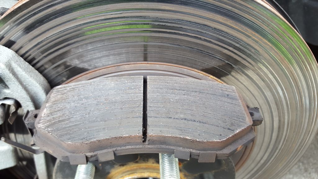

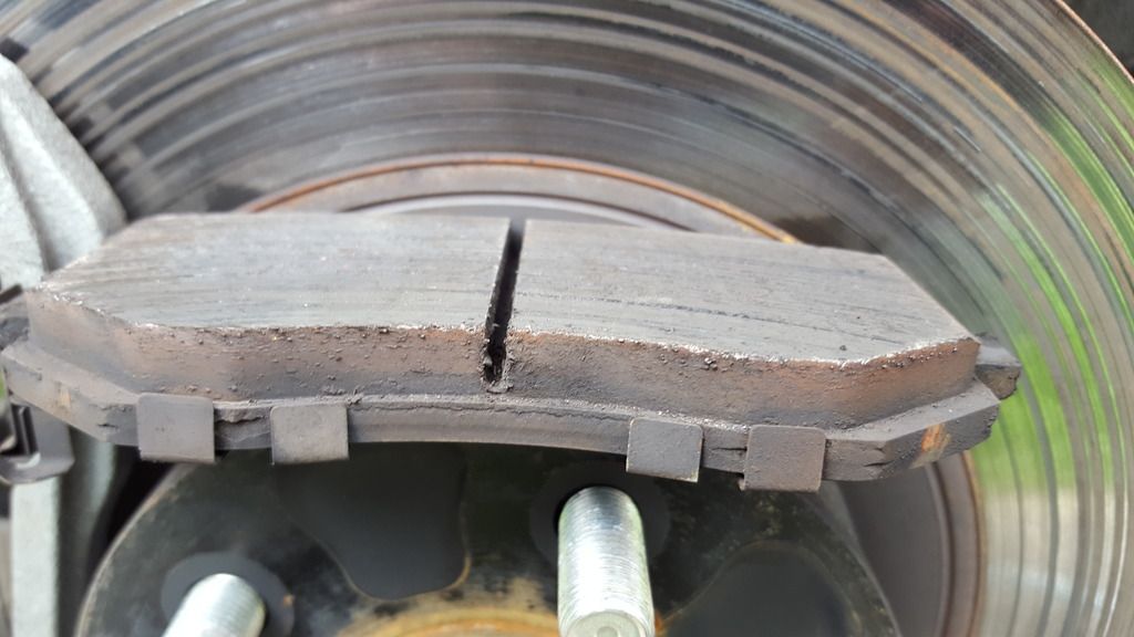

Do these pads look like they are still usable. I've been driving around on them for a week or 2 and they seem like they are working better than they did a day or 2 after the track day. Maybe they cleaned up a bit? I'd hate to trash them because they look like they still have tons of material left just for normal daily driving.
Did not catch what pad you are running on. The pad is smeared all over the rotor. If you have questioned regarding a brake pad setup for your setup and driving skill set, please PM us and we can help you out.

This is the stock pad.
