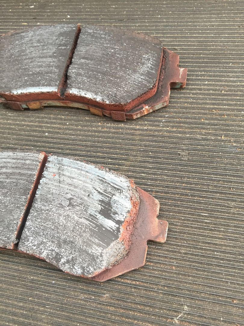

Swapping my pads back out after the track this weekend, I noticed this. Never had any brake fade at all, stayed out of ABS almost entirely. Its on both front outboard pads. The pads are Project Mu RSF 01A. Stock calipers. My current theory is using them cold on the way home from the track they maybe got too brittle?
I have the exact same pads as well and they are also crumpling off at the edges. However, I might be overheating the front brakes quite a bit. Thermal paint shows that I am above 610degC for front rotors. Had Porsche GT3 brake ducts installed but no improvements noted (610degC pink paint still turn white). No issues with the brakes in terms of braking power or fade though. Would like to know as well if this is a problem too.

Definitely overheating the pad.

Well I guess ill try to take it easy with the back to back hot laps. Time to start saving for a bbk then huh?

Step up your compound a bit more. Try the 999, or Racing Sintered.
Ok I'll look into those. I thought the RSF 01A were along the same lines at the 999 as they were rated 200-900C. Is that not the case?
Don't look at just the temp range...
You may ultimately still need a BBK.
Ok, I will give those a shot. Thanks for the help as always. I'll continue recommending you guys to everyone I come across looking for a shop in the states.
