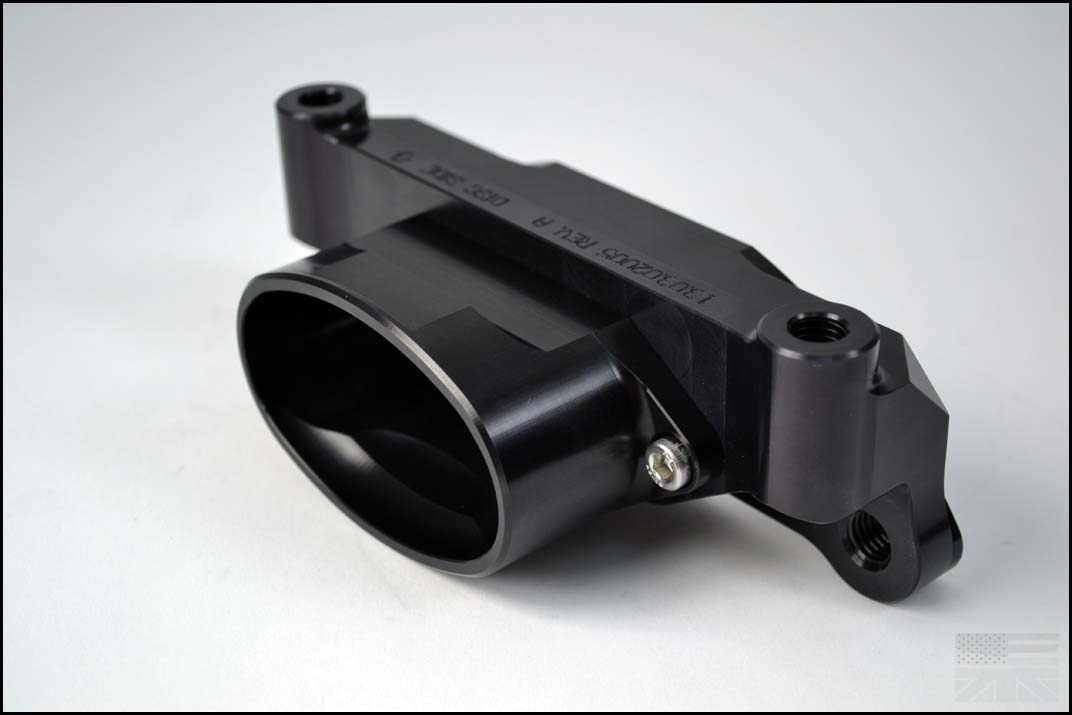

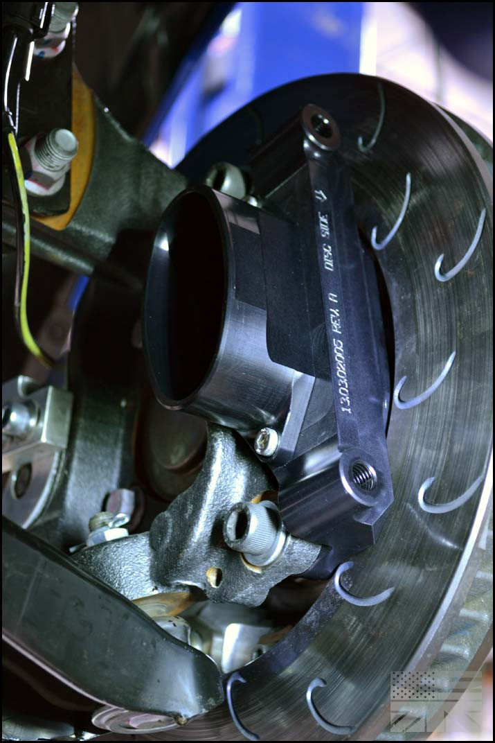

  • It comes with a super trick caliper bracket that integrates a brake duct (see below). That will save you a good deal of money, and you'll know you have a properly designed duct solution that puts the air where it needs to be.

Here's our duct...all billet aluminum. It's a killer piece and a huge value to be included in the kit price.
