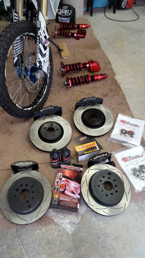

batlwagn 03-03-2016 11:17 AM
Checking out RR racing. They are vendors on this forum I just installed there brake kit and it was really easy and not terribly expensive. I think it was like 1800 shipped front and rear
Sent from my SAMSUNG-SM-G890A using Tapatalk
batlwagn 03-03-2016 11:18 AM
Attachment 132432
