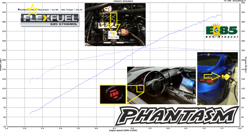

Moo! Lol, but seriously, this is on delicious FnG correct? Did you retune at the dyno at all? If not,that is looking pretty dang good for an e-tune
lol, the Moo! gets everyone. This is the Delicious FnG with flex fuel. No tune adjustments, just two back to back pulls within half a horsepower of each other. Couldn't ask for more in regards to consistency. I'm very happy with the end result.

Was that dyno on e85? ?
Sorry for the confusion. I've updated for clarity:

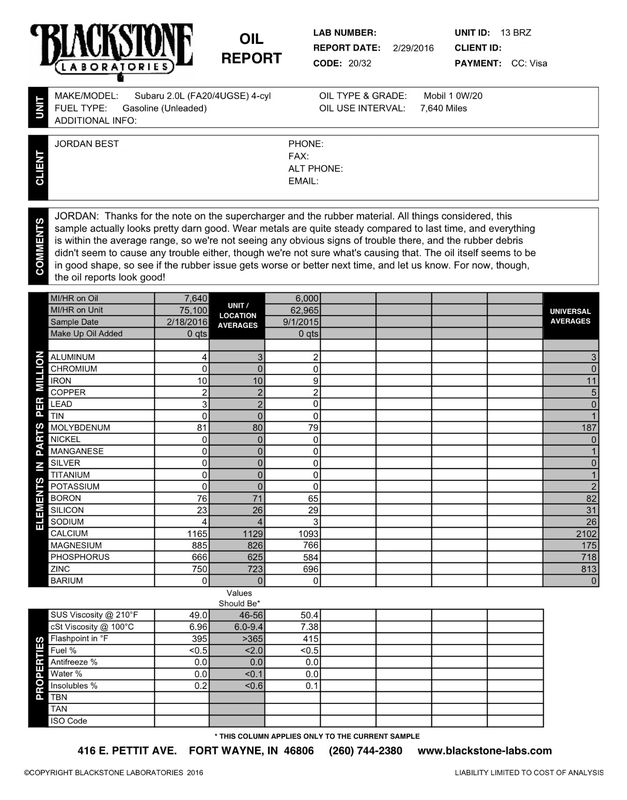

Yea, I am on stock bottom end (75,000 miles young). It has around 10 track events on it, and maybe 30+ autocrosses, a few trips to the dragon, and frequent spirited driving. So far so good, I just sent off an oil analysis sample to Blackstone a few days ago, so we will see how the results look. This oil sample has a bit of SC driving and E85 in it.
I have a track day both days this weekend, and an autocross next weekend. So, I'll keep this updated if something happens...fingers crossed though haha. I don't have the cash for an engine build right now.

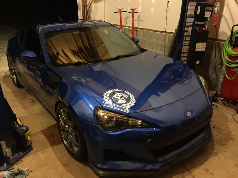

Prior to the event, I put the car up on the lift, and did some general track prep. I did an oil change, swapped out transmission and diff fluid, and emptied my catch can. It was pretty full, so I am glad I took the time to do it.

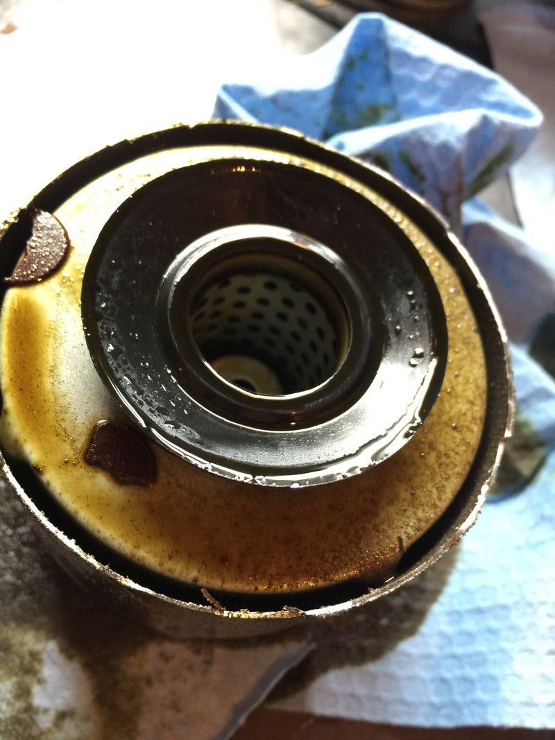

When changing my engine oil, I came across a piece of rubber foreign matter in my filter. It was lodged in one of the five small holes in the filter, but I pulled it out for this picture. I am not 100% certain where it came from, so I cut open the filter and verified it wasn't a piece of the insides of the filter.
Foreign Matter:
Inside OEM Filter (Ignore Cutting Wheel Bits):

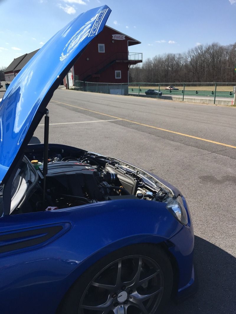

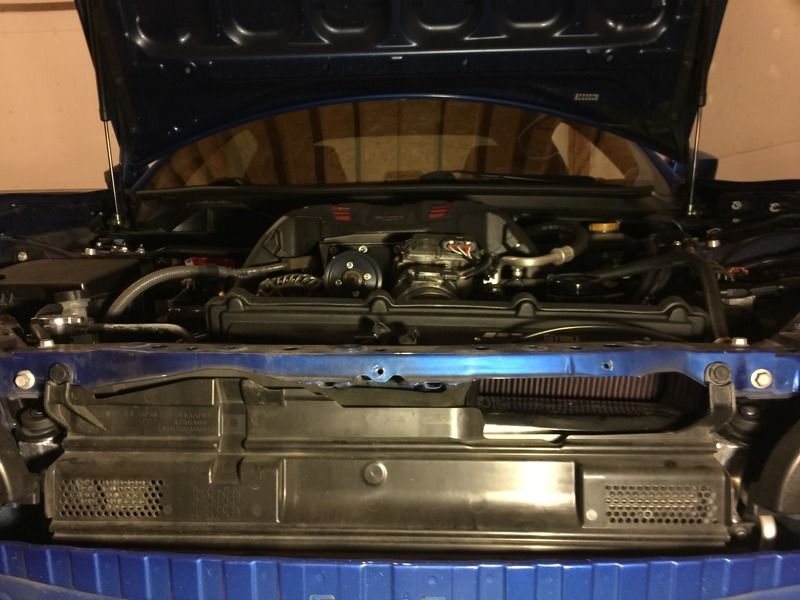

I also pulled my OEM snorkel before the event, as I had reinstalled it after putting in the Edelbrock kit, and was later informed it was not supposed to be there:

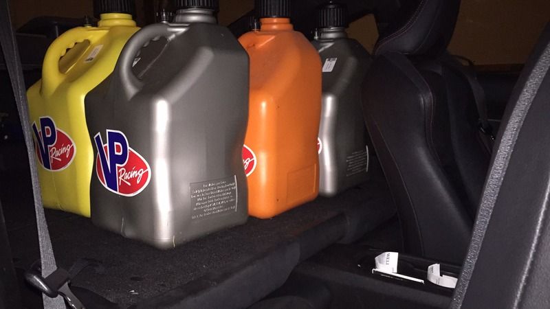

I ended up taking my own E85, just to be safe:

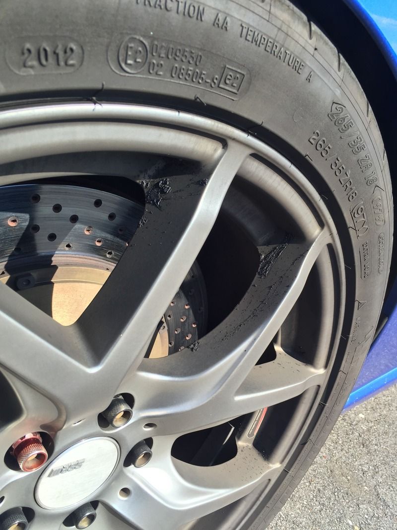

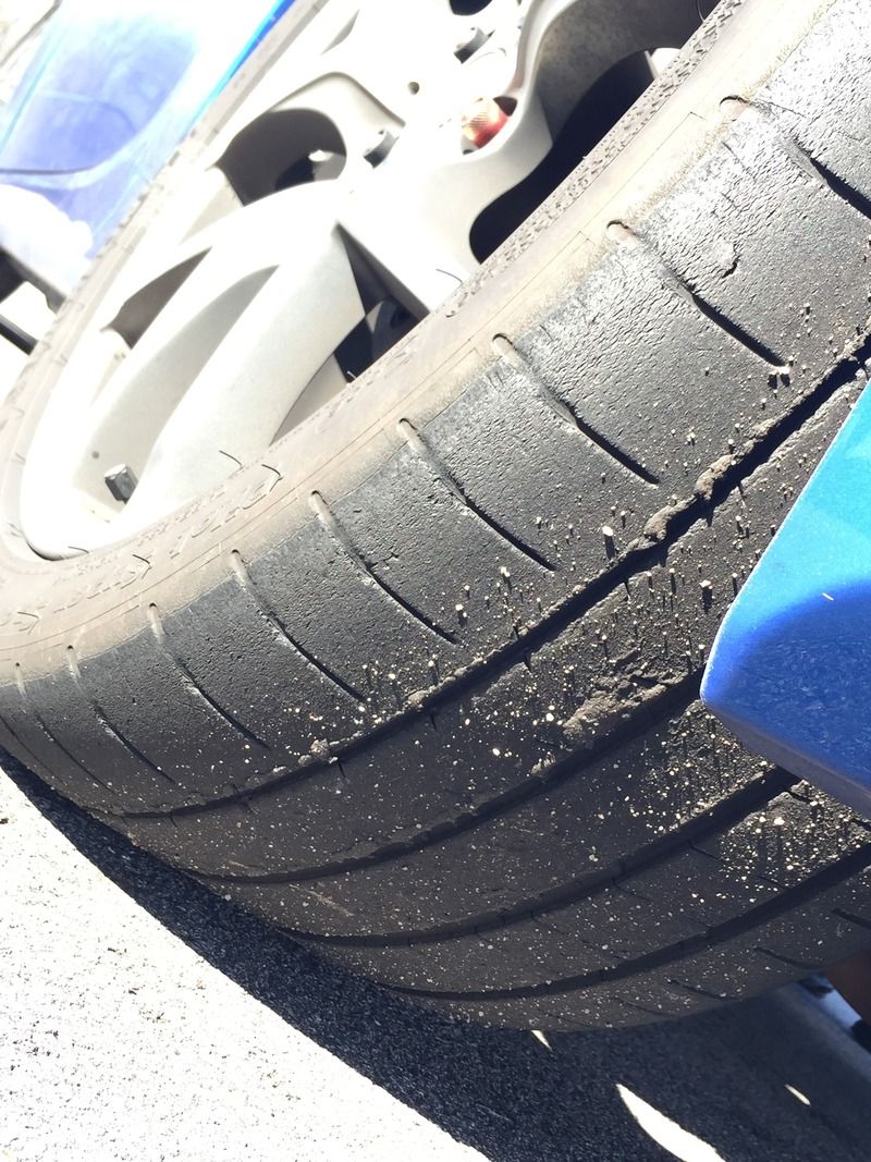

Sunday was a lot warmer, starting in the 40Fs and ultimately reaching close to 70F by the middle of the day. The tires did a lot better, and the 265s were great.
PSS with some heat in them:
Rubber Errywhere:

Could that foreign rubber material be from your oil cooler/ lines?
Old 03-01-2016, 05:20 PM   #84
NotSoJDM
NotSoJDM's Avatar
Drives: '13 BRZ | '04 E55
Location: Wake Forest, NC
Posts: 916
Thanks: 401
Thanked 717 Times in 284 Posts
It could be. I don't know if you are on the FB group, but that was my initial suspect source, as that is the only changepoint I've made since the last oil change. I sent off an oil sample from that change as well to Black Stone, and everything checked out. I'm going to reduce my service interval, and check it again to see if anymore shows up in there when I pull the filter this next go around.
Here's the report:
