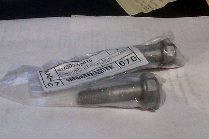

Originally Posted by jdrxb9 View Post
Well, I won't be sourcing any alternate bolts, genuine OEM are in hand:
(sorry for the cell phone pic)
Two day turnaround was surprisingly quick!
Also, the car is at the dealership , but no pics of that yet (probably tomorrow).
With luck my bolts will be here tomorrow. Have wheels in hand.... waiting on the tires too, but those are tomorrow or Wed.

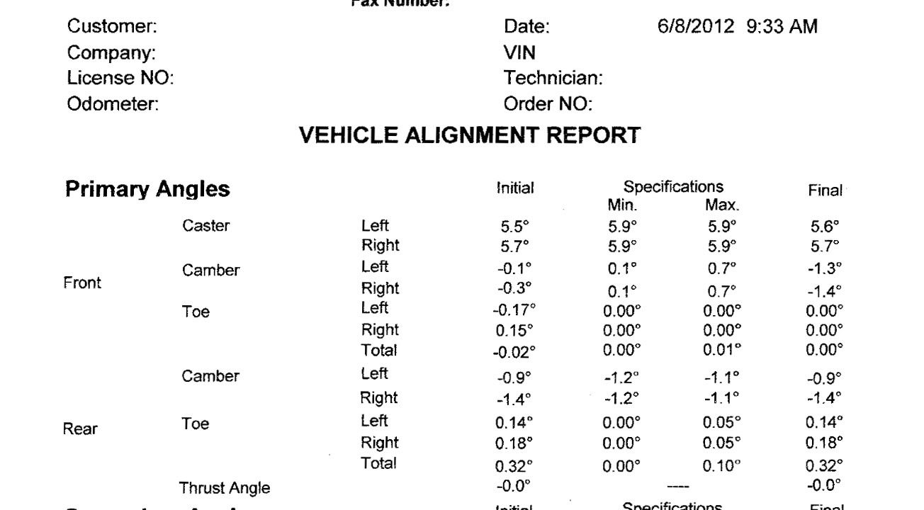

Well, had the BRZ on the alignment rack this morning and installed the OEM camber adjustment bolts.
Stock upper attachment bolt right, OEM adjustment bolt left:
And here are the results:
Overall, I'm pleasantly surprised with the front. The stock alignment was at least slightly negative already. The bolts gave about a whole degree of additional camber. FYI, a quick check with both stock bolts loosened and camber maxed out showed -0.4 deg., so nut much there.
In the back, despite the FSM saying:
Inspect the toe-in and camber. If the values are not within the specified ranges, adjust the installation bolt holding the rear suspension member to the vehicle body, or the bolt holding the upper control arm and rear suspension arm so that the values fall within the specified ranges.
No adjustment other than the cammed bolt at the inboard end of the toe control link was evident to myself or two techs. So, rather than just start loosening every bolt, I decided to leave it as is. We'll see how the balance feels and go from there.
I've only driven it a couple miles, so I can't yet give any impressions on the driving feel with these settings.
Cheers!
Edit: All measurements are without driver weight.
jdrxb9 is offline   Reply With Quote

Thank you soo much! Great info! I was expecting much less available neg camber. Still not great, but better than I expected.
