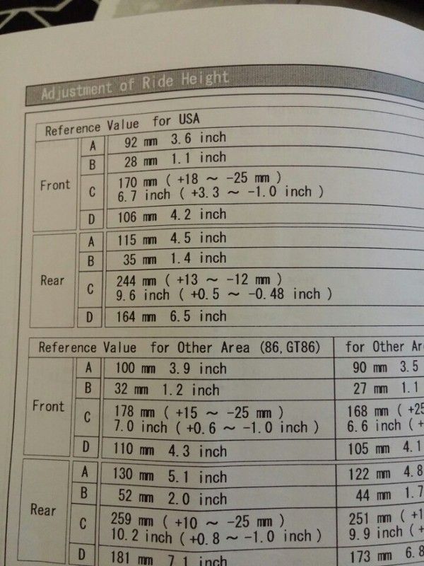

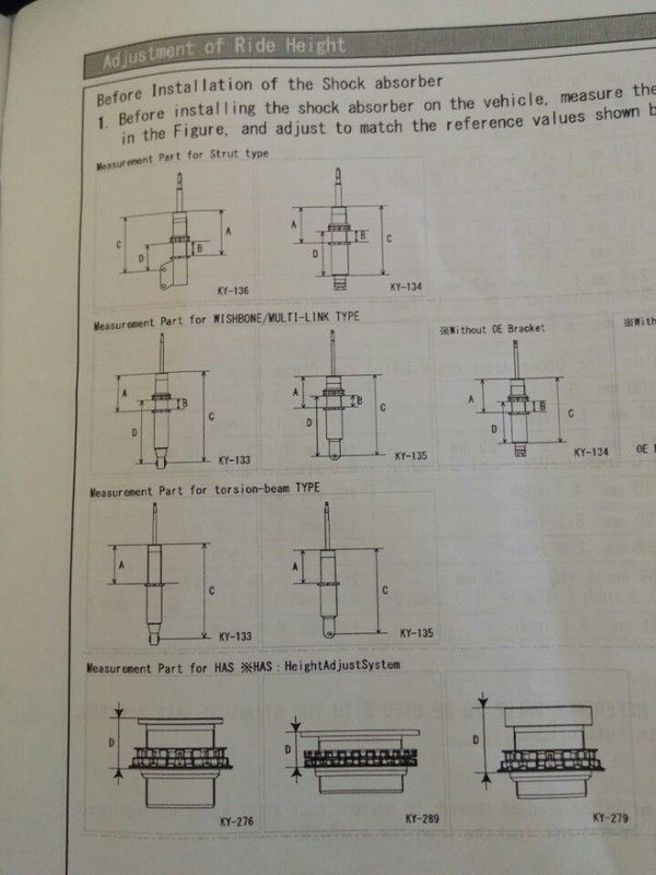

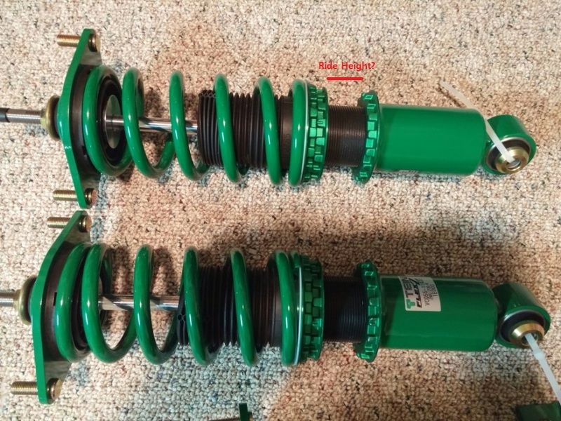

I am probably gonna install Ten Flex Z very soon.
red mark line is where ride height adjustment i can make?
checked manual front B is 28mm and Rear B is 35mm
so i need to make 28mm and 35mm between collar for default setting?
I am trying to lower 1.2
thanks
