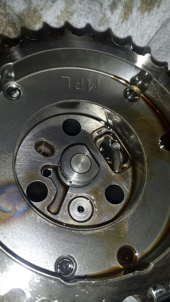

Thanked 28 Times in 18 Posts
Ive been having the same issue. Last week i got a cel with traction light with the code p0016. For those of you still having issues after getting your ecu replaced it could be faulty cam timing gear.
Attached is the image of mine. Its been replaced along with the ECU and i should get my car back today. I will post more when i get the car back to let you know if its been fixed.

Originally Posted by JoeCFRS View Post
Attachment 129602
I had a intake cam gear replaced and ecu replaced. Its been maybe a thousand or so miles and the CEL hasnt come back.
Attachment 129602
We're you intake valve angles not identical? I'm starting to think mine might be a cam gear as well
Sent from my LG-D850 using Tapatalk
Not really sure what that means. But i had the intake cam gear and the ecu replaced. All seems good so far.
