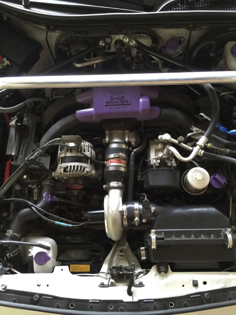

How far off is it? Should it be centered with the throttle body?
Attachment 126471
Attachment 126472
That looks good. Maybe a slight adjustment right if you can.Picture of the batteries then?

You should be hitting four easily. Double check your connections, and try realigning the compressor. Take your time with the alignment.

So after compressed realignment etc, car was pushing over 4psi at 3500 rpm. This kit really is great. Few of you know, but I just switched out my turbo setup last week & installed this the other day. I think I'm going to go the direction of building my motor & doing a high HP build. I thought I would offer my kit here in this thread first to anyone that's been waiting a while etc.
