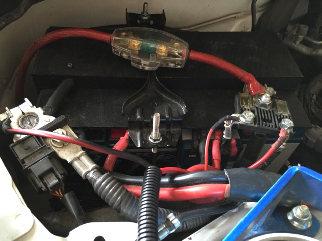

Sojhinn is offline   Reply With Quote
Old 12-04-2015, 04:47 PM   #9725
Dallen
Boooooosted

How far off is it? Should it be centered with the throttle body?

Old 12-04-2015, 04:48 PM   #9726
Sojhinn
Lightning McQueen Driver
Sojhinn's Avatar
Drives: Limited Red 6MT BRZ
Location: San Diego
Posts: 2,242
Thanks: 753
Thanked 1,167 Times in 644 Posts
Mentioned: 77 Post(s)
Full throttle Electric Supercharger Build Thread
Attachment 126471
Attachment 126472
That looks good. Maybe a slight adjustment right if you can.Picture of the batteries then?

Originally Posted by Sojhinn View Post
That looks good. Picture of the batteries then?
1.5 dump pack
RocketBunny FRS // Phantom ESC // OFT x E85
Dallen is offline   Reply With Quote
1.5 dump pack
Attachment 126473
You should be hitting four easily. Double check your connections, and try realigning the compressor. Take your time with the alignment.
Edit: KIT IS SOLD
So after compressed realignment etc, car was pushing over 4psi at 3500 rpm. This kit really is great. Few of you know, but I just switched out my turbo setup last week & installed this the other day. I think I'm going to go the direction of building my motor & doing a high HP build. I thought I would offer my kit here in this thread first to anyone that's been waiting a while etc.
The tq250, with the 1.5 dump pack. Upgraded relay, everything works. No issues
I have an OFT loaded with the ESC maps for 91/E85, as well as an FA20 4-1 header for sale too if you want to further boost you're power gains. PM for details.
