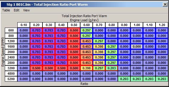

I concur with @KoolBRZ that the PI DI map posted by @thambu19 works extremely well and runs really smoothly.
http://www.ft86club.com/forums/showp...&postcount=112

Hey I totally made those up in my head so you guys might want to make some tweaks here and there. Did you add some spark where we are running di now where it was pfi before. It is important to do that.

Hey, I've tried to tweak it a little
Sent from my HTC One_M8 using Tapatalk
There wasn't a single change that didn't make it worse. Next I'll try adding some timing in the DI areas.

Have been running some high intake AVCS values (45) but was getting knock at cruising speeds (2800-3000 rpm, at 0.9-1.5 g/rev) even full DI with IAM dropping.
I've just re-reduced the AVCS intake cam to 40 which has settled the knock signal and about to add in ignition.
I'm not sure if it was true knock or just intake AVCS noise too close to the cam advance limits, but the engine is behaving much better with a bit less cam, more PI lower down, full DI up top.

Too much intake advance means intake is opening when piston is travelling up in exhaust stroke. This can send exh gas up intake runner and re breathe increasing residuals and knock. So there is always a fine balance.

When you get a chance can you try something like this? At WOT I have gone 100% DI. This means you need to a degree or so more spark there to use the full potential. If you do not then it will feel sluggish compared to stock calibration.
Flashed your PI/DI map yesterday. Added 3 degrees ignition advance at
load > 0.90 up until 3,8k rpm or so. And there's still headroom for more spark left.
Feels better than before. Seems worth to play around with these tables.

Be careful adding too much spark at engine speed making peak torque. Up to 3800rpm should be okay. Some engines I have worked on goes straight to pre-ignition. Don't want thatone

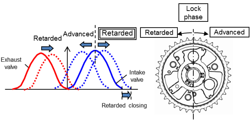

I'm not too active on this forum lately but I did get caught up with this thread, as these things tend to die and suddenly get revived.
The AVCS intake side has the negative values @thambu19 and others were talking about because it is a mid lockpin AVCS. That means the intake side can retard, not just advance. The retard is a fuel economy thing. It's the same type of AVCS that's on the FA20DIT. In fact, it's the BorgWarner phaser technology that Ford uses on the 5.0 Mustangs. On those FA20DIT engines when you delete the tumble generator valves you need to advance the AVCS or it runs like crap without all that tumble motion in the combustion chamber.
more details (mostly relevant to FA20DIT) here http://forums.nasioc.com/forums/show....php?t=2687550

Any one else notice the fuel trims go crazy after loading these tables? How are you guys dealing with it?

Could it be because now engine is scavenging with pure air instead of air fuel mix
