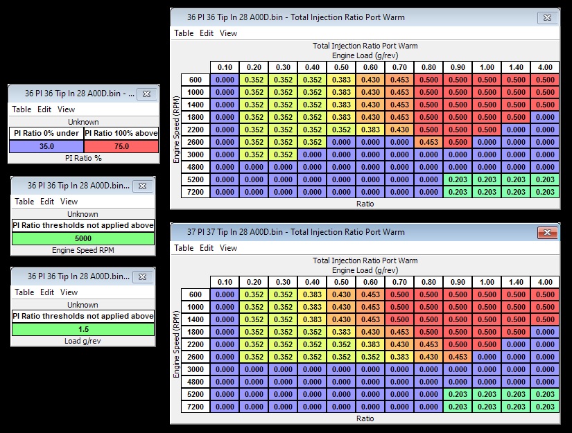

Any idea why you didnt go 100% DI at low speed WOT? This is where the DI really comes into play for knock relief
The wrx's only have DI and they can't run as much timing as we can because they don't have PI for knock prevention.
WRX is a boosted engine running at higher torque outputs so cannot be compared to our engine. Boosted engines also use a lot more turbulence and hence do not need as much spark advance to get the same combustion. In short we cannot compare the two.

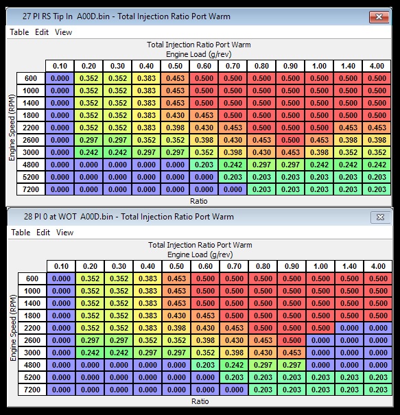

I'll try it and compare these two
I'll try it and compare these two versions of the PI tables. As you can see, from 1.0 Load on up and 2200 rpms and up till 5200 it is 100% DI. I'll try the two tunes with this as the only change and let you know how it works. Having an AT is great for engine tuning because every change has a much more dramatic effect, but when it isn't running right it sucks the joy right out of driving.
If I say yes, will that make you think I understand?

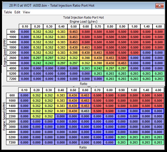

The zero PI at WOT tune, (28) runs better at WOT. Definitely. So I need to use full DI sometimes for performance reasons. Now to find out when and where.

Hey @thambu19 and @Kodename47. Tell me what you think about the next table I'm trying. Old vs new. A lot more DI and less PI. I've changed the thresholds back to the stock settings.

I just got back from the beach. Tried 2 tunes on the way out, weak power, 28 mpg. made a new tune while I was there, good power, good AT shifting in "D" mode, mpg went from 28 to 31 as we went down the coast from 20 mph to 60 mph. Power was just about a perfect match with the transmission. Refilled in Salem and drove 75 mph north, which usually gets about 30 mpg, this time got 33. PI was off at 75 mph, (2600 rpms) with loads from .5 to .7, but back on with loads up to .8 or .9. See pic below, 36 is the tune I ran today, 37 is the one I'm trying out tomorrow. Will it get better mpg with PI on at 75 mph? Or does it get better mpg with PI off at cruising speed?

When you get a chance can you try something like this? At WOT I have gone 100% DI. This means you need to a degree or so more spark there to use the full potential. If you do not then it will feel sluggish compared to stock calibration.
