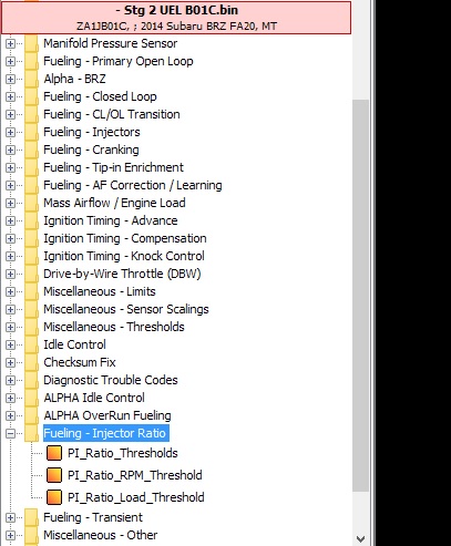

Have you got your xml edited now?
Originally Posted by thambu19 View Post
When you get a chance can you try something like this? At WOT I have gone 100% DI. This means you need to a degree or so more spark there to use the full potential. If you do not then it will feel sluggish compared to stock calibration.
Can you use the PI thresholds now? If not, cells below .35% and 5000 rpm will be the same as zero %. I also wonder if there are any PI multipliers in effect, because that would cause the cells with .703 to exceed .75 and then those cells are the same as 100%. However, I don't see how running your PI table will hurt.
Because of the way my AT trans shifts in response to throttle input, this is one table that should be different between MT and AT tunes. I'll try it with the thresholds bypassed over .5 load instead of 1.5, so that the cells below 5000 and .35% will have some effect. Then I will compare it to my other tunes and let you know.
If I say yes, will that make you think I understand?
Sorry I didnt pay too much attention to thresholds but if you can change the thresholds to get these ratios that will be cool. As I said before going 100% DI at wot requires you to add more spark in those regions where I took away from PFI and added DI

@thambu19, it's time to practice what you preach
Here's a zip file with the B01C definition file. In RomRaider open definition manager and delete your current file first, then unzip this def and add it to the def manager. Open your tune and look between ALPHA OverRun Fueling, and Fueling - Transient. You'll see a new category there called Fueling - Injector Ratio. Inside that are the thresholds.
P.S.
This is a def file with definitions for the cold start tables as well. You can easily modify your cold start to be lower in rpm and quieter.

Thanks: 140
Thanked 79 Times in 61 Posts
Originally Posted by ztan View Post
Are you using OFT or Tactrix? Pull your stock ROM first and let us know what your calibration ID is then we can get you up and running with the right defs.
Hey @ztan. I bought a Tactrix but the unit failed to connect/read so sent it back and they shipped me another. Should arrive in couple of days. Since mine is 2013 MY im sure its pre B01C. I want the dealer to update it to B01C since they introduced the Pre-Ignition and idle fixes with it? Im worried that if I update it myself they will find out that the calid is different when I take it in for some warranty work.
I am itching to try out some PFI/DI cal changes and E85. The Takeda Intake has arrived and I want to install that as well with the right MAF scaling.
I love the intake honk from 4K onwards but pretty sure I can make it happen even earlier by changing the AVCS. But that is pretty much what OFT OTS cal does too. They moved the Exh timing creating more overlap and this should make more intake noise although their reason for doing it was for more torque and less torque dip
@KoolBRZ Thanks a ton mate. Got a chance to try out 100% DI? I don't know why the OEM did not calibrate for full DI at low speed WOT. Defeats all my engine knowledge. I can only think of emissions as a likely reason for staying with 50% PFI DI split.

Blast you @thambu19! Your idea worked.
@ztan and @KoolBRZ
I will pull up my rom and send you folks and you can hook me up with the latest RR def that I can use.
I loaded a tune with your suggested revisions first, and didn't even load any of mine to compare. It was so much better! @!#*&% you! I made 4 other tunes to try out, and now they are all worthless! Blast you and your intelligent mind! Now I'm going to have to rethink these principles you based your revisions on so I can find how far the limits are so I can push it to the limit.
I am glad it worked mate. Did you adjust the spark whereever the new tune uses more DI than base tune? You should. DI can take way more spark than PFI. We should create a smooth blend. At lower loads we should go as much PFI as possible.
