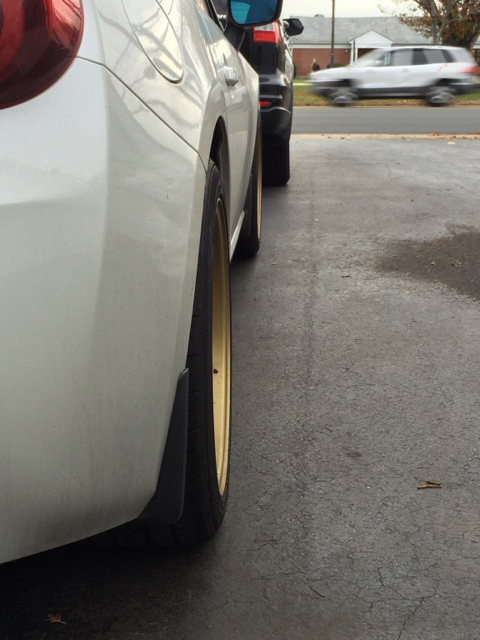

I took a photo this morning to show the poke/flush of my setup.

I love it. Thank you!
I'm considering this set up, or Mach V Awesome wheels for next spring (+42 offset).
Do you have any rubbing at full lock?

No rubbing at full lock. But the inner barrel of the wheel slightly touches the spring perch now and then. I don't hear it or feel it but when you take off the wheel you can see a slight mark on the wheel from it touching. I will probably use a 3mm spacer on the front soon.
