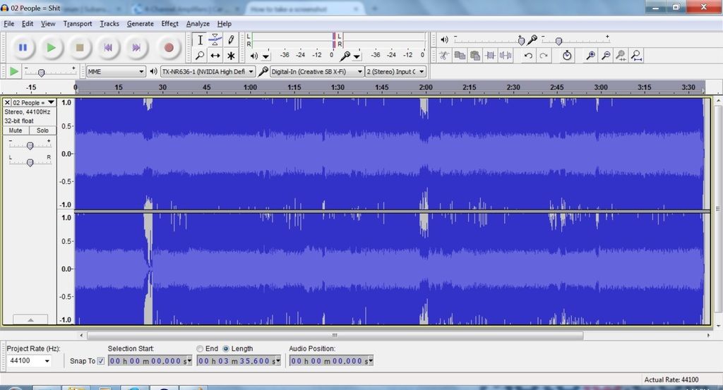

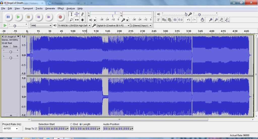

What regular rock music? Like I said before, Slipknot is very compressed. If by regular rock music you mean classic rock, it usually has 25% or less of the total average output that Slipknot has, over time. That could very easily explain things, which is what I've been trying to say. FWIW, I've killed one set of speakers, with some EDM. It was entirely my fault, from poor volume control. I say this, because my system was set up to handle any normal music at full volume without issue. But, EDM is not normal, and this particular song was brickwalled even further than Slipknot is. FWIW, I could play Slipknot on my stereo at full volume without damage.
Crest Ratio is the difference in decibels between the loudest peak in the sample to the lowest average sound that is above the noise floor.
For instance, this is Slipknot. Super compressed, to the point of being clipped. 6db crest ratio, this is like playing pink noise through the speakers. Pink noise is generally what thermal power ratings are created with. If your crossovers, gain, and eq aren't out of wack, speakers should be able to handle this at rated power without issues.
This is a new, remastered version of Hotel California. Just the first minute or so. This one was compressed compared to the original version, but much more dynamic than Slipknot. Less demanding on speakers, because playing this at the same volume setting as Slipknot will send less power to the speakers. 7db crest ratio.
This is a vinyl rip of Hotel California, much more dynamic than the remastered version, much less power going to the speakers at the same volume. 15db crest ratio.
For comparison, here is the Telarc version of the 1812 Overture, my favorite classic piece. Even more dynamic than Hotel California, even less average power going to the speakers. 18db crest ratio.
Here, for fun is Slayers Angel Of Death, the remastered cd version. 7db crest ratio.
This is the vinyl version of Angel Of Death. 13db crest ratio.

And then the Creed and Mangione are clearly less dense than the slipknot with the Evanescence in the middle.
That is why I say you will heat the speakers more with slipknot than with the Mangione.
(changed my comparison just to fit the pics).
