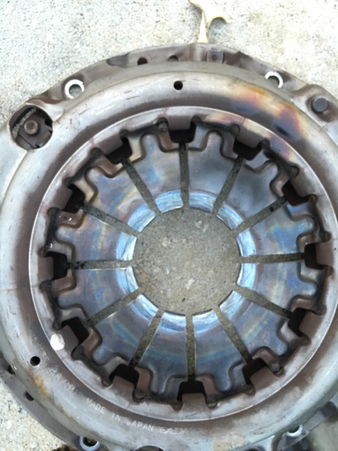

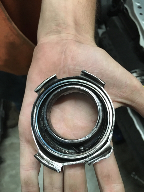

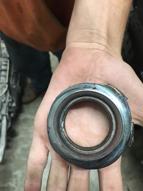

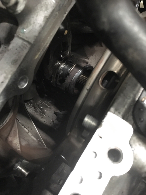

Ok since I'm in the middle of doing a clutch/flywheel/bearing replacement I thought I would chime in. Currently just below 100k miles. Was at the track and throw out bearing decided to melt so I ordered all new parts. Forgot to order new throw out bearing clips since mine melted so waiting on that little part. Name:  ImageUploadedByTapatalk1445640508.853645.jpg

63,000 and throwout bearing ruined everything
Forgot to mention I have the sprinted intercooled supercharger kit for the last 25k ish miles
