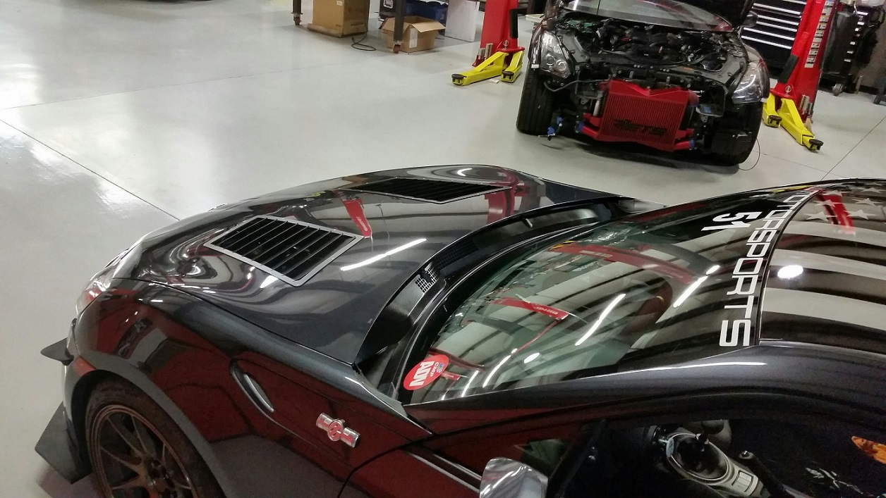

We installed those vents in our carbon fiber hood and fenders for added venting. We've had nothing but great results.

Here's a picture of the vents on the race car.
