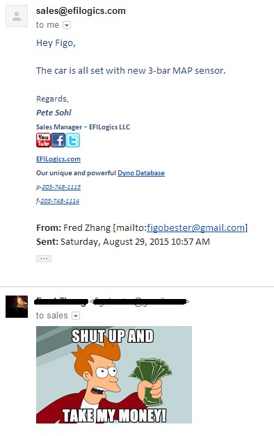

Update:
Seems like they made it. People are right. They are one of the best.
I will go to pick my car up tomr.
