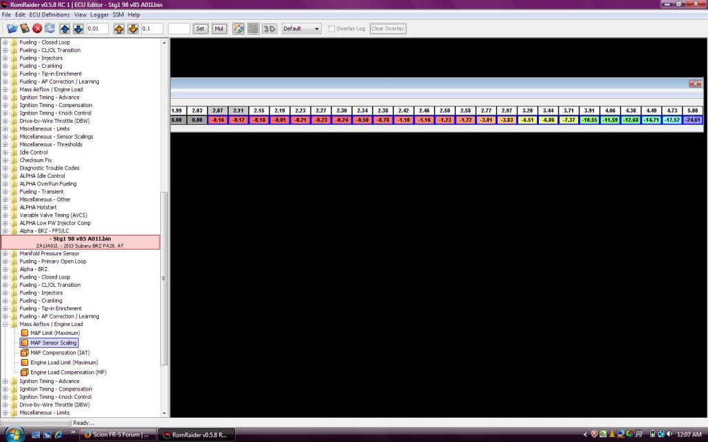

so these are the maf scaling values in the stg 1 tune (which look to be the same as your stg 2 tune) compared to my UEL stage 2 tune. Are these the correct changes to make?
Attachment 118382
also, not quite sure how to run DI to 7000. How important is that?
Yes, it's correct.
Also copy the injector ratio tables. They have re-scaled axis.

Originally Posted by Wayno View Post
Yes, it's correct.
Got it, thank you. How exactly does changing those injector ratio tables affect AFR/LTFT? In other words when I datalog this new tune, what changes should I be looking for that weren't due to changing the MAF scaling?
