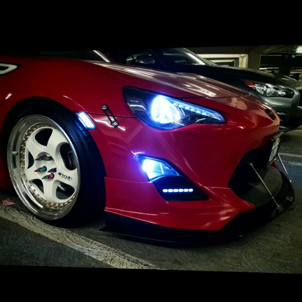

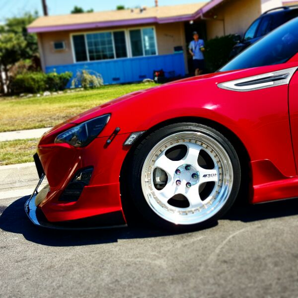

I have 1 inch drop from springs running 18x9.5et35. I had to run 215/40 front and 235/40 clears no problem. I had 225 in the front and it didn't rub when sitting. It will probably rub off I hit a bump though lol. No fender work done or camber or anything like that.

Do you have any more pictures? Thanks for all the info btw
Jaydawg86 is offline   Reply With Quote
Old 07-12-2015, 11:49 PM   #52
thien
Drives: Scion FRS
Location: US
Posts: 342
Thanks: 326
Thanked 297 Times in 166 Posts
Mentioned: 36 Post(s)
Size:  62.7 KBName:  uploadfromtaptalk1436759318666.jpg
Size:  48.9 KBName:  uploadfromtaptalk1436759366818.jpg
Sent from my SM-G920T using Tapatalk
