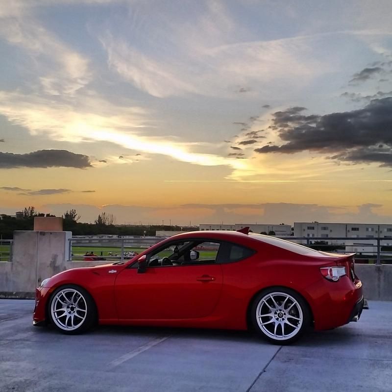

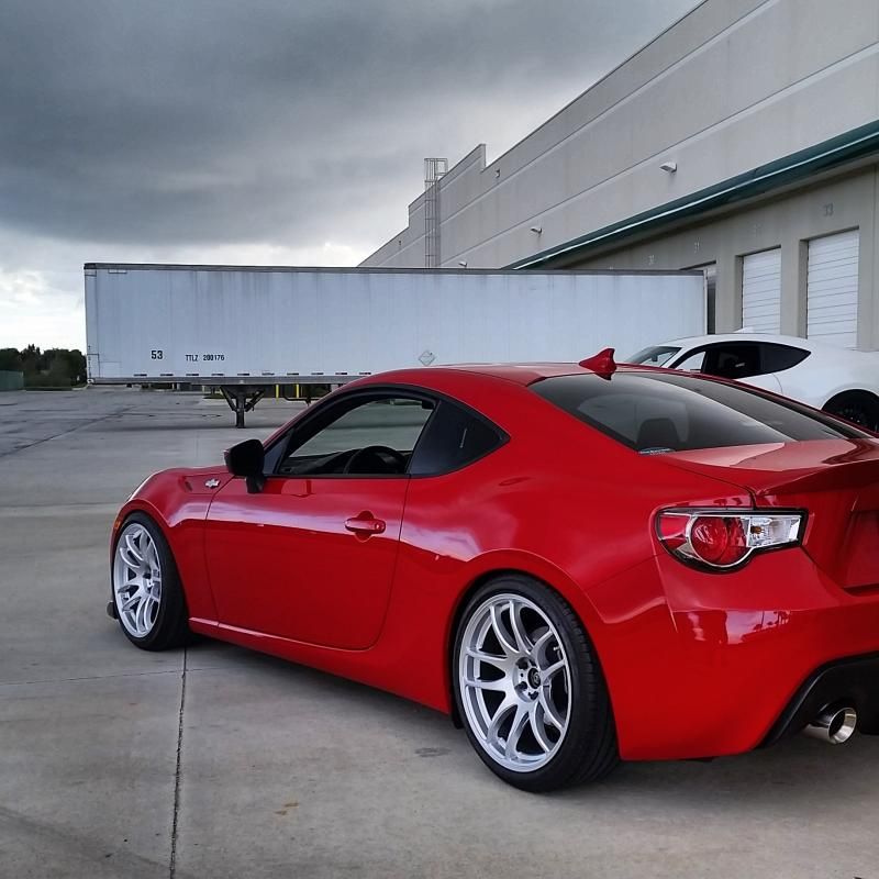

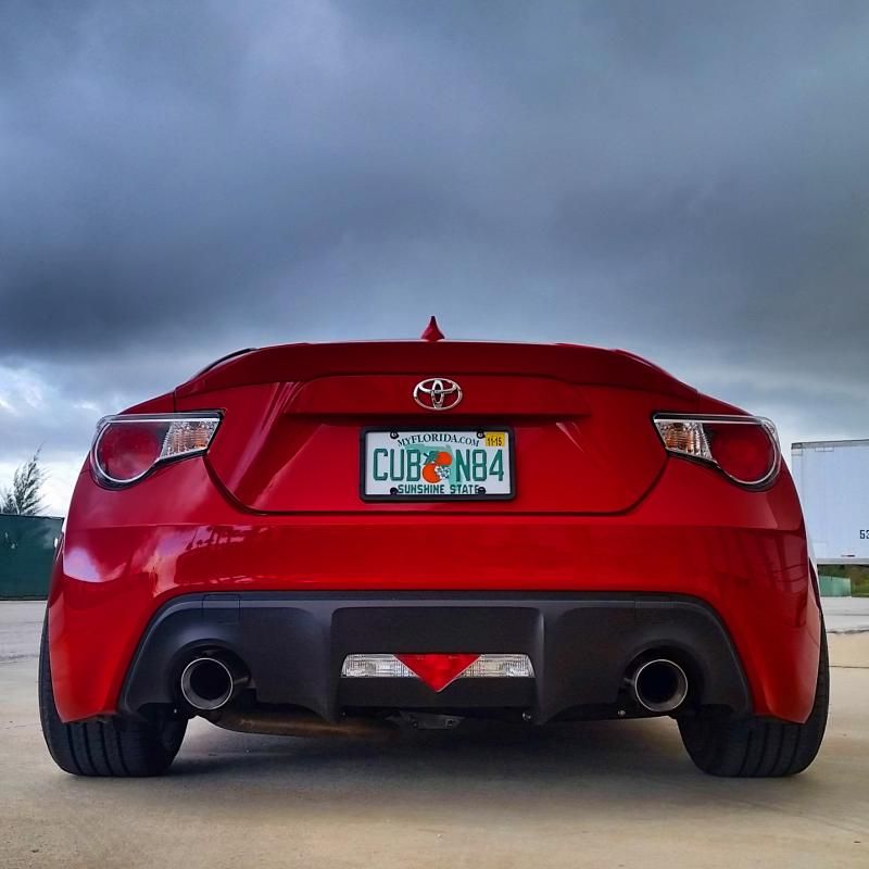

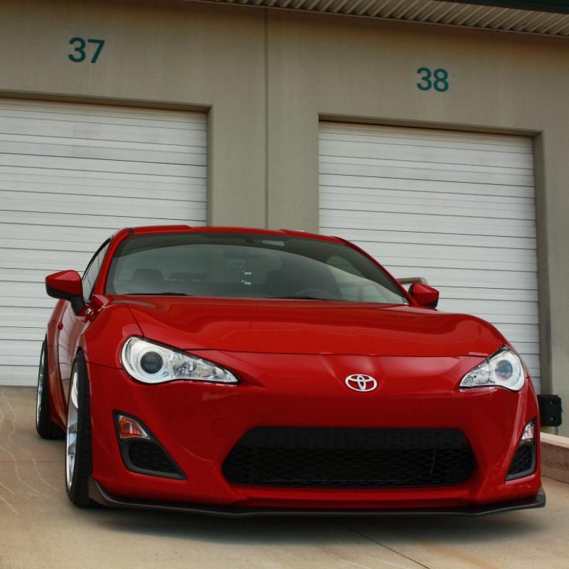

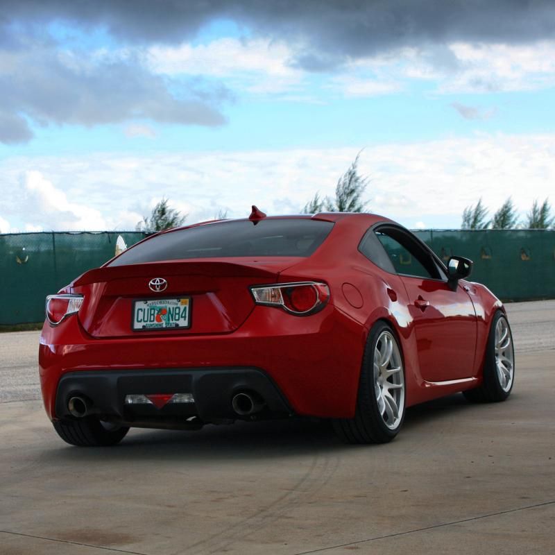

Vordoven Forme 9 18x9.5 et34
I ordered a set of Vordoven Forme9 in 18x9.5 et34 on black friday. Got an amazing deal as they were still taking preorders. It did take a month for the wheels to arrive, but it was totally worth it.
18x9.5 et34 Vordoven Forme 9 in hypersilver
255/35/18 Bridgestone Turanza ER33 (rubs on uturns, hard turns, and hard bumps. switching to 235/40 today)
ST Coilovers (lowered all the way up front, 13 turns up in the rear. -1.7/-1.9* camber in front -2.7/-2.9* camber in rear)

Looks good! I want a set, but I cant decide between 235/40(slightly tall) or 225/40(slightly stretched) and hyper silver or hyper black on a silver brz. What are you using for camber adjustment in the front? Natural camber in the rear?

I honestly am not sure if the 235/40 will fit yet. I will let you know how it goes. What suspension are you on? The ST coils are slotted so I just used the stock camber bolt and pushed the hub in all the way and tightened it down.
It was a tough choice for me between hyper black and silver as well. Went with silver because it matches the clear lighting everywhere.

What spoiler are you using?

That's 5 Axis spoiler.
