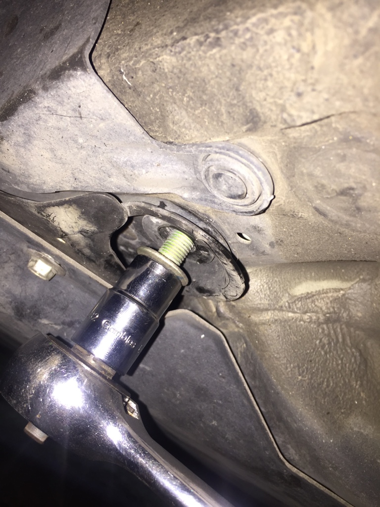

Found this. So i tightened it and retightened all my end links to the point where i thought they would break and its fixed👍🏻
