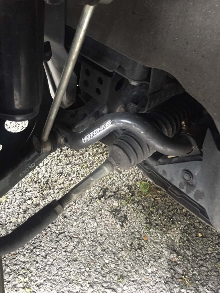

I just got the hotchkis stage 1 kit. Springs and front and rear sway bars and they are clunking like CRAZY. I had the springs installed 2 weeks before the way bars and the spring a never made a sound, so its got to be the sway bars. Everything is tight but i cant for the life of me figure out why stuff is clunking. Does anyone know what it could be? Im using OEM front end links too btw. Thanks guys
johneastvold 06-02-2015 02:27 PM
Attachment 111203
Pic of driver side, thats what i feel is hitting on both sides. Just cant confirm
86_Insider 06-02-2015 03:59 PM
Can you snap a few other photos a little further away? Just to get another look a a few other things.
I have seen issues in the past where the end link bolts feel tight but the powder coat or paint on the bar causes it to free up and be just loose enough to make noise. I usually lightly sand down the coating around the hole in the sway bars to stop this from happening

86_Insider 06-02-2015 06:26 PM
Don't see anything jumping out. When does it make the noise? All the time, larger bumps, going in and out of driveways?

vroom4 06-02-2015 08:35 PM
Tighten the end links again, until you think it's gonna break.
Top and bottom nuts, not just bottom.

johneastvold 06-02-2015 10:26 PM
Attachment 111252
Found this. So i tightened it and retightened all my end links to the point where i thought they would break and its fixed👍🏻
