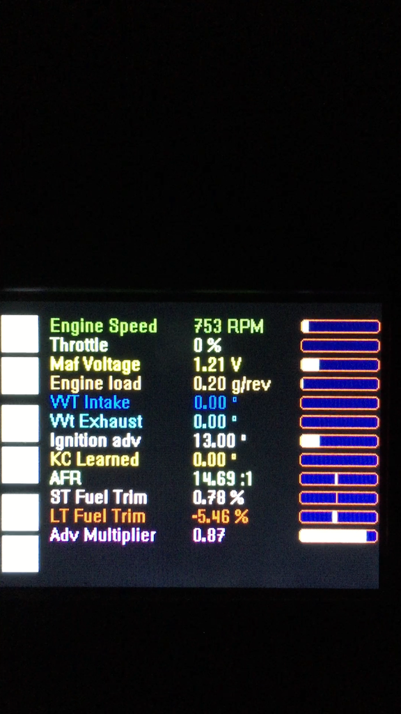

Whenever I go to real time diagnostics I get this message...
weird part is, if I keep clicking on OK on that screen eventually it works
Can someone please take a look at the reading and tell me if something is out of range or anything I should be concerned with.

Your numbers won't necessarily be accurate until you update your template file (which you have to do via computer). Otherwise, if your advance mult is indeed accurate, then your engine is pulling timing. In normal operation, it should be 1.00. AFR and fuel trims look ok.

First thing you need to do is go to the openflash website and download the latest template file. Update your OFT through the manager once you get it.
Hook up the tablet to your car and see which rom you've loaded up. If in doubt, reflash the Stg1 rom again. Before flashing, make sure the connection is secure (the cable) and don't open/close anything while flashing your ecu.
Advance multiplyer being under 1.0 probably means you have a bit of knock. Log for knock and see where it's occuring.
