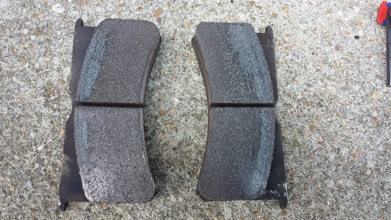

I am running the AP Sprint kit and I have an issue with my brake pads that I am trying to figure out. These are XP10 front pads after 2 track days. (National Corvette Museum and Atlanta Motorsports Park)
Notice on the left pad the raised inner edge.

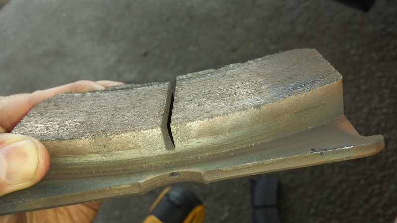

Here is a better look at it.
This is happening on the inner pad on both the driver and passenger sides. It looks to me like the pad is overhanging the inside edge of the rotor on that side. I think this is also contributing the the 'effing loudness of the brakes. They squeal like none-other. The instructor that was showing me the line at AMP had to ask if my brakes were ok. Coming into the pits everyone looks, cause there is no way you can ignore it. The only time they don't sound like a terminally injured helicopter is when I'm deep into the brake pedal on the track with them warmed all the way up. I will say that the braking performance has not been effected, and has been consistent and great every session.
I cant think of any way to adjust the position of the pad in the caliper to move it fully onto the rotor surface. Or did I install it wrong? It was pretty straightforward and nothing that I have seen talks about adjusting the caliper positioning, that would have been done by the bracket design and is the whole reason to by a pre-made kit.

Lip is normal so you can just grind it down. The radial depth from pad manufacturer to pad manufacturer is different for the D41. Sometimes it can be D42, D39, D40.5, etc.
I can see that the pads are starting to glaze ever so slightly as well. You are overheating the pads which also may mean you could be engaging ABS and heating up the brakes more than they should. XP10 on the AP Sprint Kit is pretty solid especially for your setup.
The brakes aren't bedded in properly as well. If they were, then the brakes will be pretty silent. Also note that Carbotechs do make insane banshee squeals and sometimes feel like they are grinding. It's somewhat of a CT trademark too. Try cleaning up the pads a bit and re-bed the brakes. Stay off of ABS.

You'll basically have to sacrifice your first session of the day to bed them in properly. The improper transfer layer spread on the rotor causes some inconsistent performance and wear.

That braking is fairly light, except for the hard, slightly downhill zone into T1. THat's nearly as rough as Laguna Seca, and that T1 is what is causing your brakes to get so hot.
Try using a higher temp pad next time around, to help mitigate that huge heat spike at T1.
This is assuming you're not sitting on ABS.
You *are* overheating the pad, but not terribly. The pad life indicates that the rate of wear is pretty good.

How should I go about cleaning up the pad? I could take a file to the raised part, but what do you do with the shiny glazed section of the pad?

Use a file. The ultra ghetto method to kind of "rough up" the pad is to use the pavement. The other technique is to drive around in the cold and allow the pad and rotor to scrape itself clean.

Swapping pads leaves disk surface impregnated with micro layer of pad material from the old pad that can lead to the glazing. Also can lead to squeal and erratic breaking for a short while. My track pads squeal until up to temp.
I use a belt sander to remove glaze and 3M makes a small sanding head to burnish the rotor.
