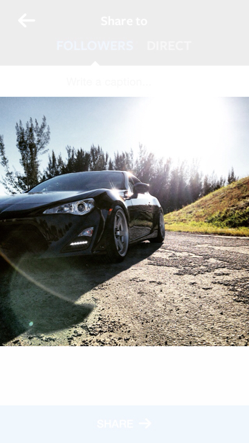

Size:  197.7 KB18x9.5 +34 w/ 235/40 nankangs. Very minimal rubbing in the front under full lock. Natural camber in the rear and about -2 in front on the camber plates.

Originally Posted by AlexWood View Post
Attachment 10882418x9.5 +34 w/ 235/40 nankangs. Very minimal rubbing in the front under full lock. Natural camber in the rear and about -2 in front on the camber plates.
Dang, sorry for that crap picture. Tapatalk mucked it up
