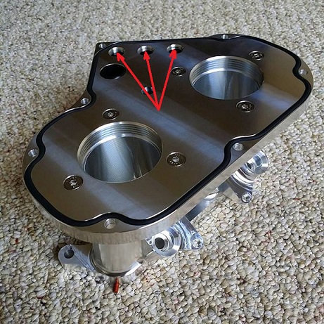

What is the function of these 3 holes?
Attachment 108749
They are manifold ports. The 3 small ones accept 1/2" and 3/8" barb to -6AN ORB fittings. The larger is a crossover hose that will equalize any variation between the two plenums.
To those who are thinking about the dollar amount only. Please keep in mind this is a prototype that was made modular so we can test a multitude of configurations to come out with the best intake manifold we can. Everyone is guessing at best what this will cost, ourselves included.
