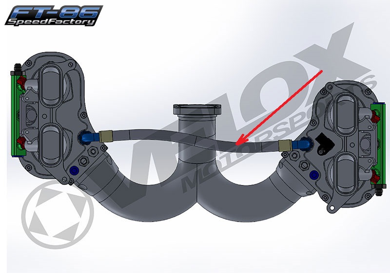

4/ Could you please tell me what the function of the highlighted hose is?
Attachment 102723
eric6 02-16-2015 02:58 AM
Attachment 102722
Due to the design, their is a possibility that bank to bank variations can occur. That crossover evens the pressure and ensures both banks are receiving the same air pressure. This is more geared towards FI but it's better to plug a provision then try to add a port later. GT-Rs and Porsches do something similar to this.
