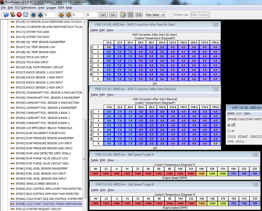

OK, so I opened my current OFT rom file up in Notepad. Found the third romid is ZA1JB01D, rather than the ZA1JA01D it was renamed to. I went to TD_D's github page. Wandered around awhile till I found the RR_ZA1JB01D.xml I need in the Alpha 32 bit base folder. Now I just have to find the two parts of the "maf correction after start" and paste them into the two corresponding sections of my current definition file.
KoolBRZ is offline   Reply With Quote
Old 04-19-2015, 06:34 PM   #221
KoolBRZ
KoolBRZ's Avatar
Drives: Silver 2013 BRZ Ltd Auto 45,000 mi
Location: Vancouver, WA.USA
Posts: 965
Thanks: 86
Thanked 452 Times in 278 Posts
Mentioned: 60 Post(s)
I Did It!
Here are the tables, modified for a quiet cold start. I have the automatic, ZAJ1A00D, and use an OFT. I needed the ZAJ1B01D RR definitions to get the appropriate sections for MAF corrections after start. So, I copied the latest RR_ZAJ1B01D file from TD_D's page on github, searched, found, copied, and pasted the appropriate sections into my current ZAJ1A00D definition file.
If you have an automatic, use an OFT with a ZAJ1A00D ROM, and want the definition file to see these tables, just send me a PM and I'll send you the xml file.

On a side note, I can't believe this hasn't been asked yet but how the hell do I disable the "P050B" CEL that I keep getting every morning? I clear it with the OFT every day and am getting pretty sick of clearing it day after day. Any tips?
akahenry is offline   Reply With Quote
Old 04-25-2015, 09:43 PM   #224
Andrew025
Andrew025's Avatar
Drives: Neptune GR86
Location: Portland
Posts: 3,862
Thanks: 1,438
Originally Posted by akahenry View Post
Are you currently running the Stage 2 UEL Map?
Look at Kool's screenshot.
It's in the codes section.
On the left it is listed, click it and you'll see the popup that's on the right side of his screenshot.
