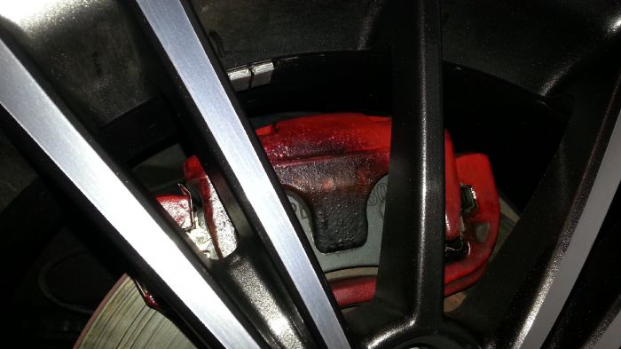

@OP, that seems pretty normal. Even my stock brakes and pads at 12K miles have that same issue on my front brakes. I'd just make sure your pads are wearing correctly and you don't have any rocks or debris caught in there. I've seen some pretty crazy wear on the inside of rotors because the breaks weren't position correctly.

I've been using Project Mu HC+ 800 pads and Dot 5.1 on my otherwise stock GT86 (unless you call an oil pressure gauge a mod). I make the front brakes smoke regularly, but no fade or soggy pedal after 20mins on track.
I get juddering due to this 'scarring' on the disc. Few 100 miles of street driving sorts it out usually.
Oh yeah, dont use 300C caliper paint either. It burns
