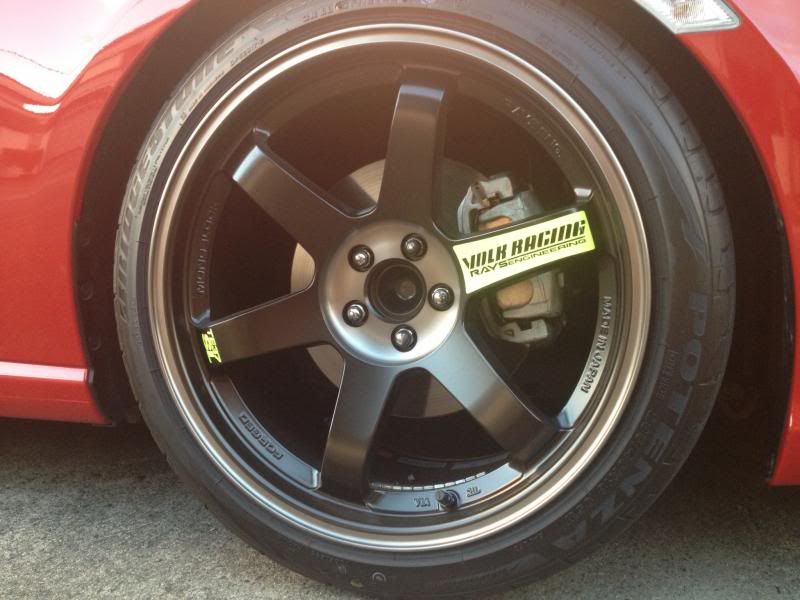

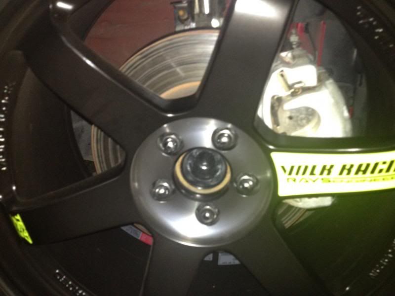

I just noticed that both my front discs have become scarred/scored. It's pretty bad. The rear discs are fine. Any idea what caused it? I tracked the car the other day, it was the second time for the car. Didn't have any problems after the first track day. I never really abused the car at the track, I would pit in every 4-5 laps to allow the engine and brakes to cool, and I never used the handbrake after pitting in.
Here's how it looks like currently
Here's how the disc looked like a few weeks ago

looks normal to me. Do any of those marks catch a fingernail?
Stock pads or other?

Normal.

Fairly normal, but looks like the pad may be overheating. Even a single lap will overheat stock pads with a decent driver. Time to get proper pads for tracking

Agreed...they look fine to me. However, stock pads on the track are a big no-no! Check out this article I wrote on how to choose the best street and track brake pads.

Yes these are the stock pads. I can feel those marks when running my finger across the surface.
I'm just curious because when I asked the other 86 guys who also went to the track, they said their front discs look normal with no scarring...

that means youre doing a good job at braking LAWL new pads will cure that issue like stated above

So consistent hard braking can scar/score the rotor? I was thinking that maybe a few stones got stuck in there when I spun out and went off track trying to drift Lol
