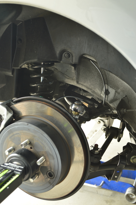

HELP! Did the ball joint go all the way in?? Or does it only sit in like 3/4 way in?!? Bc I'm not 100% sure and I'm worried that I'll have a ball joint falling out when im driving
The rod end stud should sit almost flush with the top of the knuckle, be sure that the pinch bolt engages into the stud and you should be good to go.
If you have any more questions feel free to email: tech@racerxfabrication.com
Like in this picture correct?
Attachment 105996
Yes.
Jeff@Racer X Fab is offline   Reply With Quote
Yes.
Awesome! Then I am done. Thanks a bunch and I hope to get some more suspension from you guys soon!
