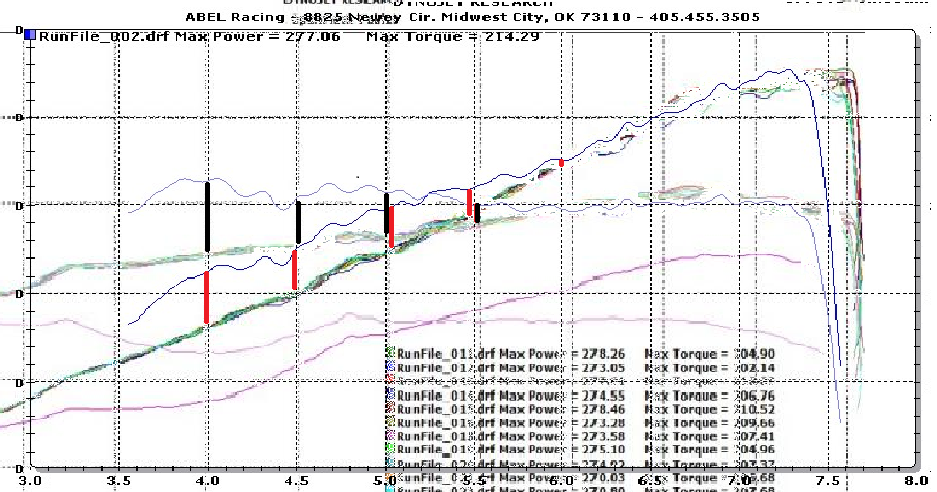

Here is a terrible comparison of the dynos, I threw together between the OFT 300 dyno and shiv's SBD dyno. Both are on the OFT maps (vortech 9 psi, SBD 10 psi) Obviously there are a ton of potential issues when comparing these but I thought it might be interesting either way. The black lines are the differences between torque and the red are gap between horsepower. HP values on the left start at 50 and go up to 300 in increments of 50.
Looks like the SBD kit has the upper hand until about 5.5-6k where they even out.
