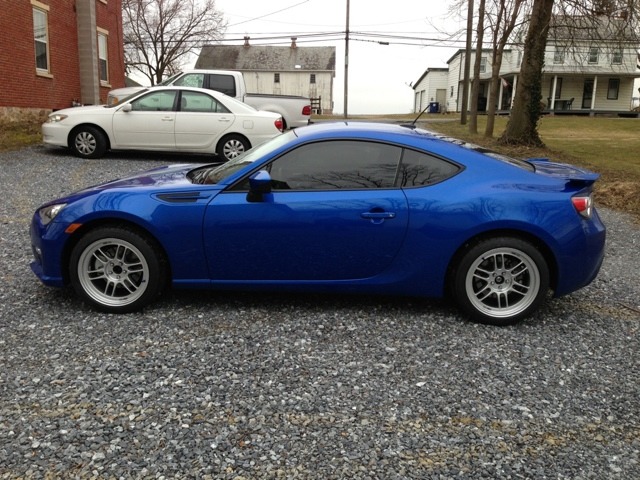

Originally Posted by uRBAN_Metal View Post
I have 17x9 +35 with 255/40 RE-11s, Eibach Pro Kit, and Whiteline camber bolts set to max negative and I'm not rubbing anywhere at all. The front tires are extremely close to the spring perch, but I haven't had any rubbing issues even after some spirited cornering tests.
I don't have any more pics right now, but here's a shitty cell phone shot I had.
As an update, I've put 6,000 miles on this year on this setup and have experienced no rubbing.
uRBAN_Metal is offline   Reply With Quote

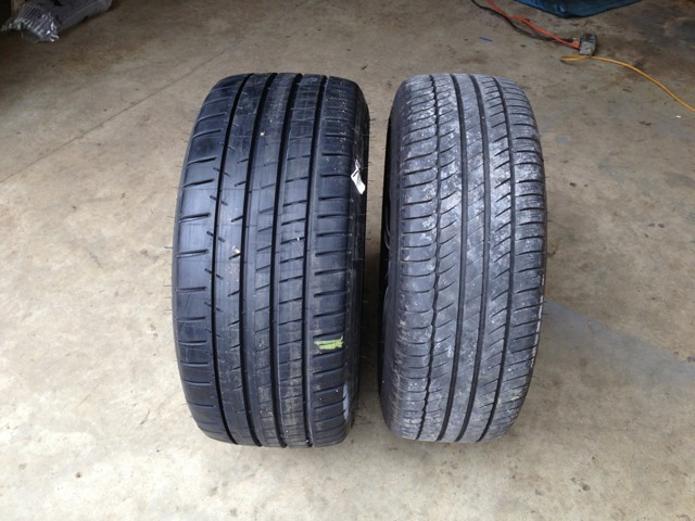

Originally Posted by wgnzlz View Post
Got the tires mounted today and put them on the car to see what it looks like at the stock ride height. Excuse the picture quality, they were taken with my phone.
PSS mounted on wheels, 39.3lbs.
Attachment 28850
Stock wheel and tire, 40.9lbs.
Attachment 28851
245/40 vs 215/45
Attachment 28852
I posted this somewhere else so I'll just quote.
How low is your car sitting at in this pic? It looks perfect!

Originally Posted by BRZ RN View Post
this is on stock height? it's really poking like that?
did you put a spacer?
No spacers. Only springs and camber bolts.
