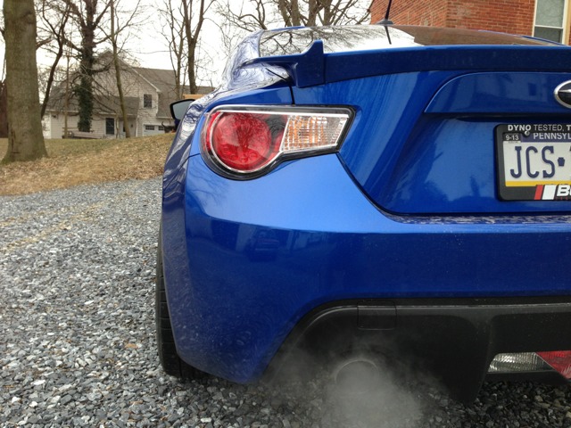

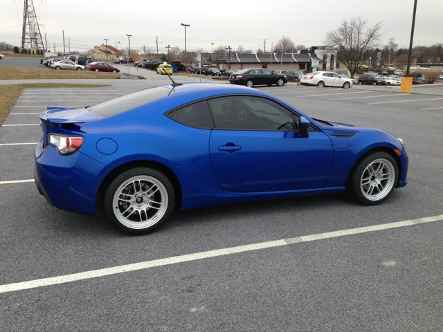

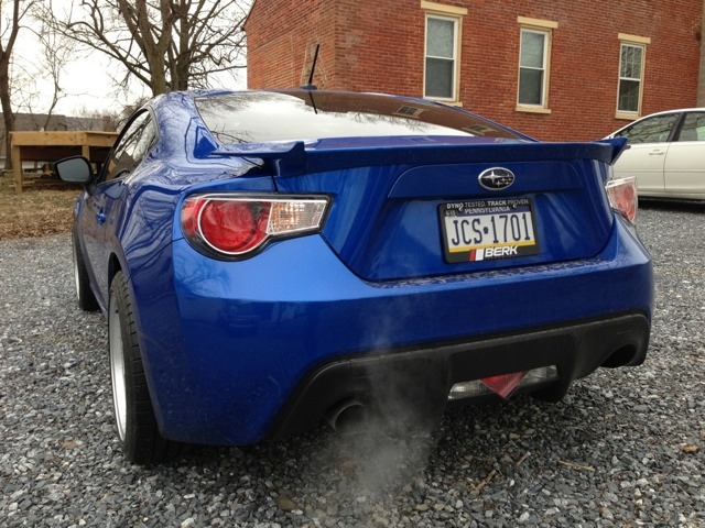

I posted this somewhere else so I'll just quote.
Originally Posted by uRBAN_Metal View Post
I have 17x9 +35 with 255/40 RE-11s, Eibach Pro Kit, and Whiteline camber bolts set to max negative and I'm not rubbing anywhere at all. The front tires are extremely close to the spring perch, but I haven't had any rubbing issues even after some spirited cornering tests.
I don't have any more pics right now, but here's a shitty cell phone shot I had.
As an update, I've put 6,000 miles on this year on this setup and have experienced no rubbing.
uRBAN_Metal is offline   Reply With Quote

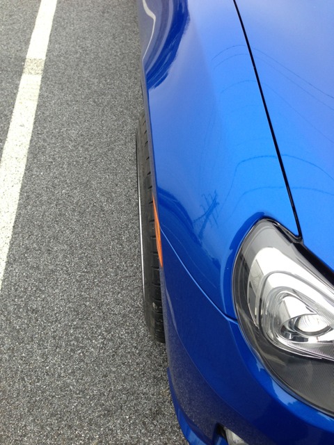

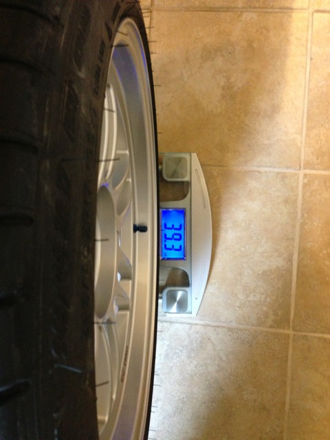

Originally Posted by wgnzlz View Post
Got the tires mounted today and put them on the car to see what it looks like at the stock ride height. Excuse the picture quality, they were taken with my phone.
PSS mounted on wheels, 39.3lbs.
Attachment 28850
Stock wheel and tire, 40.9lbs.
Attachment 28851
245/40 vs 215/45
Attachment 28852
Some pictures on the car.
Attachment 28853
Attachment 28854
Attachment 28855
Attachment 28856
Attachment 28857
Attachment 28858
Attachment 28859
Attachment 28860
Attachment 28861
Attachment 28862
this is on stock height? it's really poking like that?

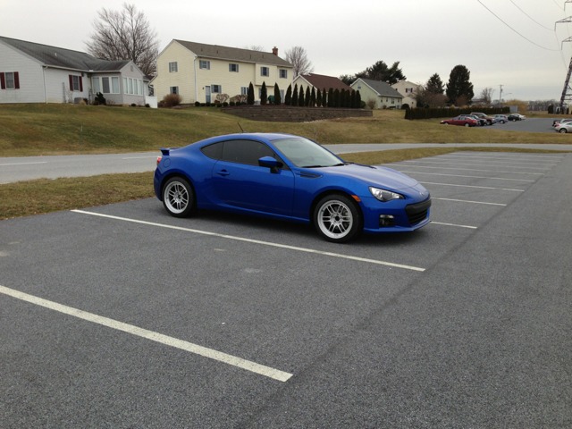

nyfries
Drives: 14 FRS Whiteout
Location: Vancouver, BC
Posts: 423
Thanks: 159
Thanked 85 Times in 59 Posts
How low is your car sitting at in this pic? It looks perfect!
did you put a spacer?
No spacers. Only springs and camber bolts.
