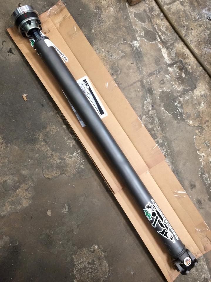

Driveshaft came in
-slicktop

This will be my last update until motor start. The current focus to have motor start-up in the next 2 weeks, with driving before May.
Clutchmasters FX850
Motor, trans, driveshaft all in for the final time.
Driveshaft
