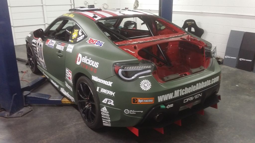

Lexan Rear Window
Last night we removed the OEM rear window (again) and are installing lexan. This will save us 8 more lbs. We don't plan on doing the front windshield because lexan gets scarred by the flying rubber and other debris rather quickly, making it difficult to see out of. Also, we probably will not do the side windows either, the weight savings is not worth the cost considering our budget.

8 lbs, are you sure? that seems like a lot. We forgot to weight ours when we did it but please weight it before installing?

The lexan weighs 7lbs. The glass was 15
