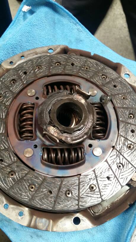

Size:  69.7 KBName:  uploadfromtaptalk1411657237107.jpg

I don't understand how the clutch fluid is getting so dirty.

Damn son, you track your car? Did you take to dealer for repair?
I have motul gear and diff fluid. I'm going to bleed my clutch MC with motul RBF600 to replace the subaru fluid before my track event this weekend. It gets dark so fast I dunno.

Right? Its weird cause its not like it comes in contact with the TOB.

I'm from Texas but live in California. Yes I took it into the dealership for repair but decided to go with a well known shop for repairs. Warning toyota will charge $800 for removal and install! I only paid 400 because they're not going to touch my baby anymore! $500 for a factory flywheel?! They can get fucked! 407 for exedy stage 1 and done.

My bearing went out at about 57K.
Replacement: Competition Clutch Stage 2

the new clutch has a new/different throw out bearing, right?
continuecrushing is offline   Reply With Quote
Old 01-15-2015, 07:58 PM   #41
Xuningshen
Drives: Subaru BRZ
Posts: 204
Thanks: 89
Thanked 125 Times in 62 Posts
clutch kits normally come with replacement throw out bearing, alignment pin and some grease.
