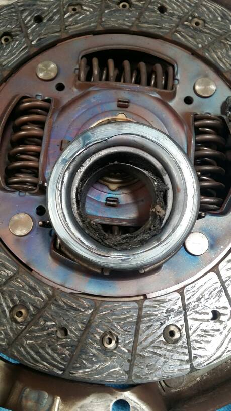

Size:  69.7 KBName:  uploadfromtaptalk1411657237107.jpg

I don't understand how the clutch fluid is getting so dirty.

Hey are any of you guys that are burning out your bearings also running LWFW?

Damn son, you track your car? Did you take to dealer for repair?
I have motul gear and diff fluid. I'm going to bleed my clutch MC with motul RBF600 to replace the subaru fluid before my track event this weekend. It gets dark so fast I dunno.

So I'm not trying to imply anything... but has anyone noticed that the only people who seem to have this problem seem to be from Texas and CA? I'd hope to say that that means its environment and not drivers (and I'm withholding my west coast driving ability jokes)
Right? Its weird cause its not like it comes in contact with the TOB.
If that had any significance it would be heat and then anyone who drives hard would be effected. I don't think that has any significance.

I'm from Texas but live in California. Yes I took it into the dealership for repair but decided to go with a well known shop for repairs. Warning toyota will charge $800 for removal and install! I only paid 400 because they're not going to touch my baby anymore! $500 for a factory flywheel?! They can get fucked! 407 for exedy stage 1 and done.

My bearing went out at about 57K.
Replacement: Competition Clutch Stage 2

the new clutch has a new/different throw out bearing, right?

clutch kits normally come with replacement throw out bearing, alignment pin and some grease.
