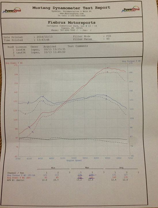

I'm just gonna post this.
This is a local guy with similar mods to me.
FT86speedfactory catted UEL headers
Fiebruz 3" overpipe and resonated front pipe
Fiebruz power blocks "IMRE" (Intake manifold spacers)
Perrin 2.5" resonated exhaust
Supertek pipe & drop-in filter
HKS intake duct
Ecutek tune (Puma93oct)
Graph shows before and after tuning.
As you can see... the stock header actually has a better tq curve past the dip...

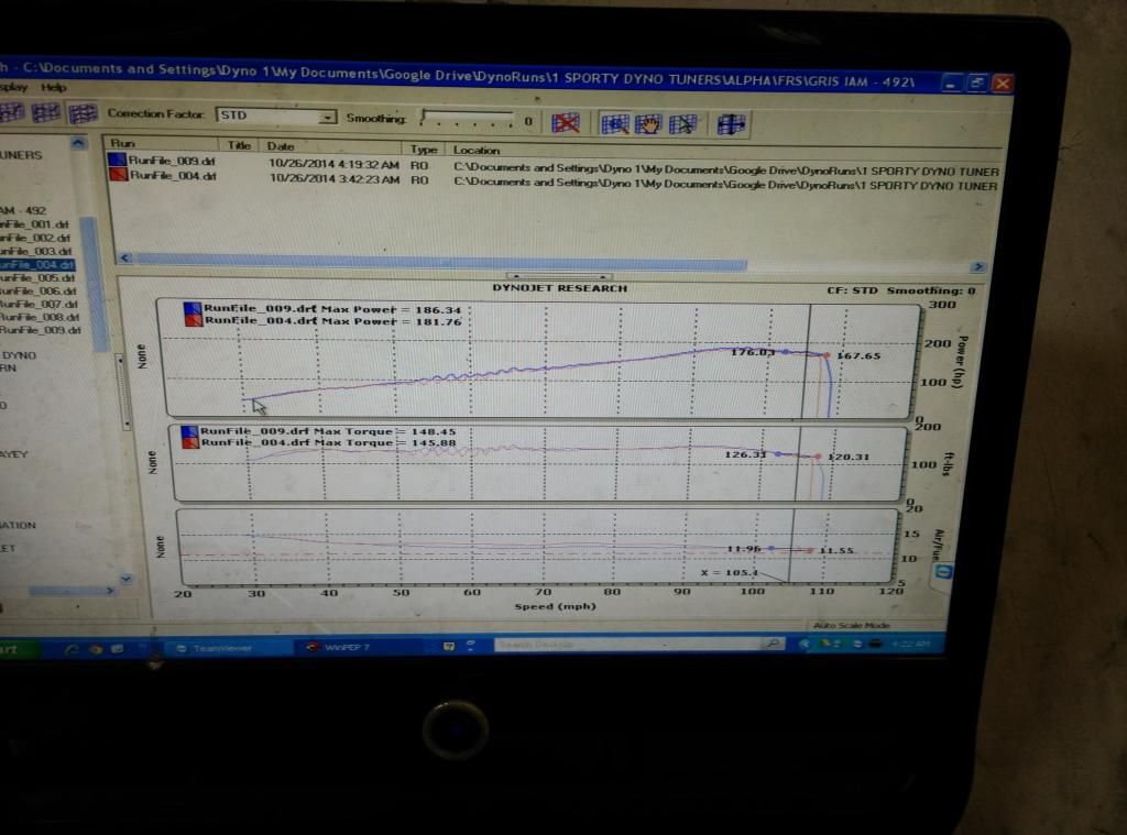

Here's my Dynojet run with a tune... Tune only gained 5hp. We did start with the OFT stg 2 UEL for BPB and got 4HP, then we started adjusting it to better suit the catted heated and managed to gain 1 more HP.
HKS intake duct
What is what? Solid with the ft86sf catted header, dashed without? If so, seems the header does as advertised. As for the generally seemingly low numbers with all those mods, don't know what is up there.
Your own graphs look quite odd, something is off. Could be the header or the cat, but it could also be the spacers or just the whole combo of mods. Flow systems can behave unsuspected in certain combinations...
Untuned vs tunned. He never did a before dyno with the stock header, sadly. But the dip is clearly there with this header untunned.
But his numbers are far more disappoiting than mine. Where mine did 170 peak HP with 91 octane and stock tune, vs his 93 tuned.
Still have yet to remove the header from my car, but I've decided on just gutting the cat and see what happens. The cat might be as restricting or slightly more restricting than the OEM cat, since I lost power in most places compared to the stock header.

Originally Posted by chas3wba0 View Post
My internet forum degree in automotive tuning tells me that going from 2.5" to 3" and then back to 2.5" is bad for flow, and would explain his less-than-impressive torque numbers... myth or fact?
Myth
when I did my dynojet run with tune where I got 186WHP my setup was with the stock catback... basically my car goes from 3" to 2.13"
Still have 6WHP over him on a dynojet.
My current mods are:
K&N Drop in, Fiebruz spacers, FT86SF header, 2.5" OP, 3" Perrin Catted Front pipe, stock CBE.
I have less mods, and a less freeflowing exhaust.
Another thing, I'm betting that if you put a tune on your friends car, the difference you feel will disappear. Hell... even I felt a huge difference between the stock tune and the tuned setup, of course I never ran a tune with the stock header, so tune vs tune is something I haven't tried yet, but I'm pretty confidence I'll feel the same difference I felt when I tuned this header.
Cartman is offline
