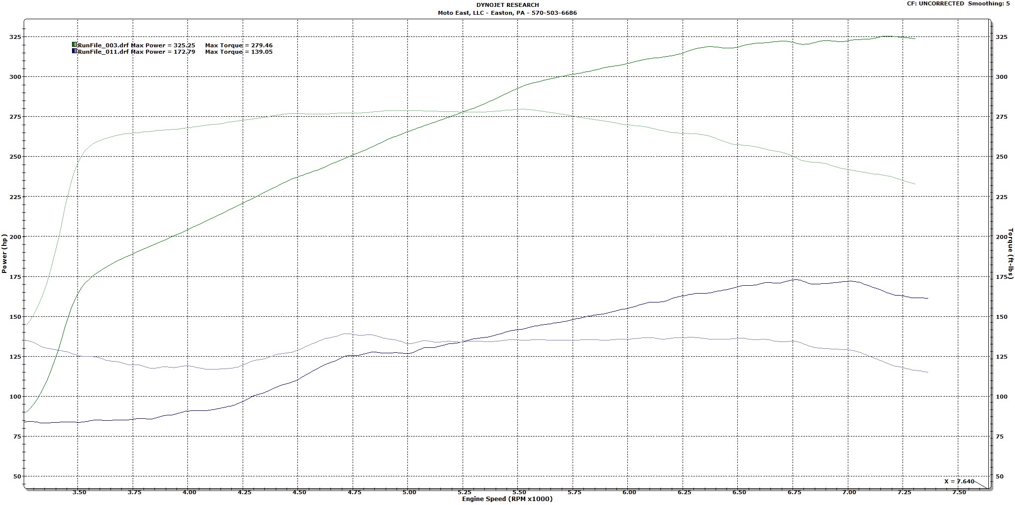

Making some progress today, caught a quick break to get on the dyno. Bear in mind our goal was to see if this could do double duty as a reasonable mid range system with upgrade potential, vs a maxxed out system right out of the box. All testing was done on e70, now that we have a sense of where the ignition timing is falling in, we will put pump gas in and watch the knock counts. For these dyno graphs, we added timing primarily to the e85 side as to make sure on pump we don't run into issues. On with the show....
Strapped down and ready for action:
This is our initial baseline taking the 210 tune, and taking out some timing (a good amount...)
You can see that the power is super smooth and comes on EARLY. This is a torque curve of a strong OEM v8. Did I mention this is on the "low timing" map? Difference is about a couple degrees. Next step is to give it a bit more timing.
Picked up a bunch of mid range with just a small change. This is showing some potential. However, in light of the relatively "low" numbers (I'm brave until about 300 tq on the stock motor) we rolled back some of the cam timing changes so that it can generate close to full boost. This is the result of the subsequent run. Unfortunately the bypass stuck for a second or two, so all the subsequent runs will be best compared at 3500+.
Now we're having some fun. You can see the gobs of torque we picked up, and this was a relatively minor change. We're still not at the cam timings we used on the 210. Speaking of the 210, how does that compare on a dyno that reads about 5% higher than this one?
You can see the 335 absolutely destroys it. The 210 plot is on e85, full bolt ons, 70mm pulley, etc...the 335 run is on an 80mm pulley and a mostly stock car with a stock header and cat back on e70. We did change out the front pipe/overpipe since we had the trans off to get the clutch, but those won't do a damn thing with a stock header and cat back. So there is still a whole lot left on the table. Our experience is that the 70mm pulley should generate about 15% more HP for a given boost level, and the stock header and cat back are surely a major restriction here. But since our goal was to see if a mostly stock car can handle it, this is exactly why we put it back to stock and wanted to test this way.
Now a few more comparisons. This is a 335 vs a turbo kit. Goes to show you that not all HP is created equal, and here particularly despite the equal HP, only one smokes the tires a gear early
And of course, for those NA, this should really make you want to upgrade!
We'll get some video up, but once this tank runs out we'll be going to pump gas. I'm very confident we'll be just fine on pump gas. Our method of "blowing off" extra boost is working just fine, and 280 torque on e70 will be an easy 250 torque on pump gas. So I can entirely see this system working for folks who run that exclusively. Then if you ever build the motor or get e85/race gas, you'll have an extra 50-100 hp at your disposal depending on pulley size, or with a built motor. The standard Raceseng 70/72.5 pulleys will fit this application just fine, and we will probably head that route in 2015 once we get a few other projects here cleared out so we can build the motor.
