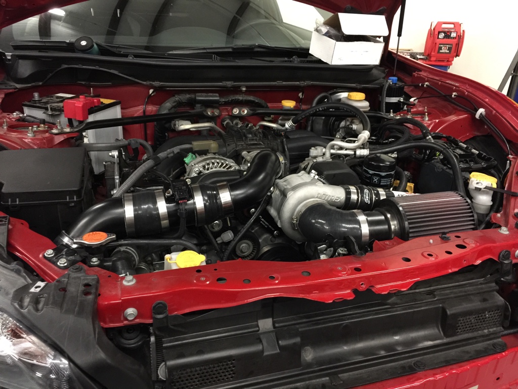

Just installed mines tonight! Waiting to button all things up tomorrow. Name:  ImageUploadedByTapatalk1414652056.894533.jpg

Originally Posted by DaiTT500 View Post
Just installed mines tonight! Waiting to button all things up tomorrow. Attachment 94709
You might want to lower the angle of the air filter slightly so that it's roughly parallel with the charge pipe. This will prevent it from touching the hood
Thanks for the tip Mike! I really appreciate it.
