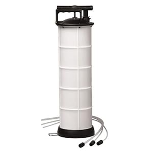

I have an oil extractor, so I'm not even going to have to lift the car up to do my oil changes. Remove the dipstick, insert tube, and pump. It works really well on my Miata (I can spin off the filter from the engine bay as well).
No muss, no fuss, no mess.
Amazon.com: oil extractor
Sounds convenient, but I think I'd be worried about sludgy crap collecting on the bottom of the pan that the pump wasn't getting.
-Rich H.
It's a possibility, but I've run a couple of tests (granted, not on my BRZ).
I drained my Miata with the drain pain hole, put the plug back in, and tried my oil extractor. It got oil out that didn't come out of the drain hole.
Also, you can tip the BRZ forward slightly or park it on a hill (since the dipstick is in the front of the engine) to get all of the oil under the dipstick tube.
How much sludge are yo expecting in a brand new engine? I can't see how the oil extractor would be worse than a Fumoto valve since their output diameters are roughly the same size.
